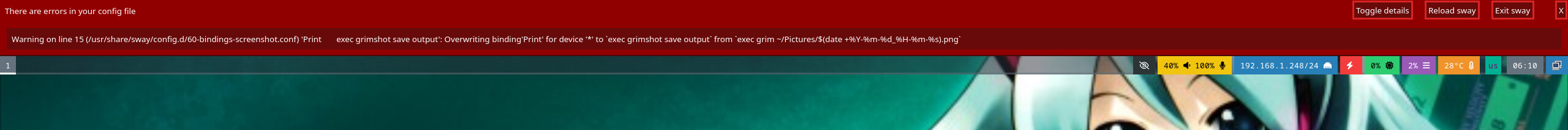

Sway Config Error
My host OS is Fedora Sway Atomic
So every time I log into a sway session I get this error message. I just hit the X and go about my day. It doesn’t cause any issues in my workstation usability.
I added these lines to my sway local override config that lives in my home folder:

This solution works. But I get this quirky little error message when I log in and am just wondering if anyone can shed some light on that.
From what I see in the screenshot: that is not an error but a warning of of the original binding being redefined. Your custom binding works after all.
A possible way to suppress the warning might be to comment out default binding for <print screen> key so that there were no redefinition.

What has most likely happened is that you have included the /usr files in your custom file in your home directory.
What many of us do, is copy the file from the usr directory and then modify it. Look at the bottom of your config file and see if the /usr files are included.
I do agree though, that there should be some way to force it not to recognize a duplicate entry or as @ugnvs suggested, to disable the warning.
I haven’t been able to find an original keybinding in the file so it may be as you said, just a warning that it has been altered from the default. This did however prompt me to review the config file again and learn some useful keybindings that I haven’t learned yet, so thanks for that!
include '$(/usr/libexec/sway/layered-include "/usr/share/sway/config.d/*.conf" "/etc/sway/config.d/*.conf" "${XDG_CONFIG_HOME:-$HOME/.config}/sway/config.d/*.conf")'
That is exactly what I did and it appears the /usr files are included. Now that I know more about this message, I’m not sure I want to alter anyhing. I certainly don’t need to and the local override is serving it’s purpose. Thank you for your help! I am a little more familiar with my system now and that satisfies me.
