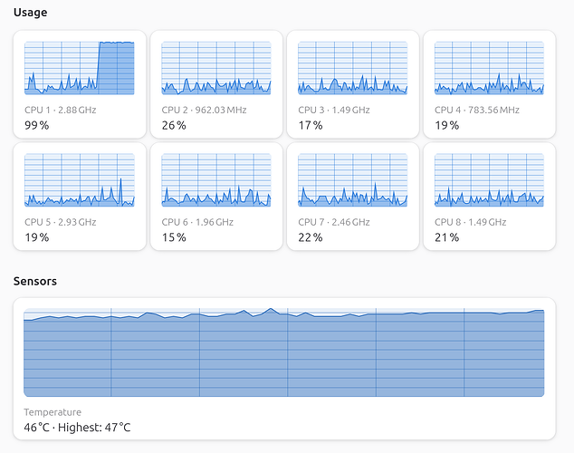

Hi @oswald_carter That actually makes sense. On battery the CPU clocks down to save power, so that stuck process is eating a much bigger slice of a smaller pie. On AC it’s running at full speed so the same load does not consume as high a percentage of CPU.
So, it’s not really doing more work on battery, there’s just less headroom available on battery, so it shows up as 98% on one core. It may not be that one reason but that’s likely the reason.
You can see something a bit similar where my CPUs are max out on this device when it’s config to stay locked at 800 MHz even though it’s capable of 3600 MHz:

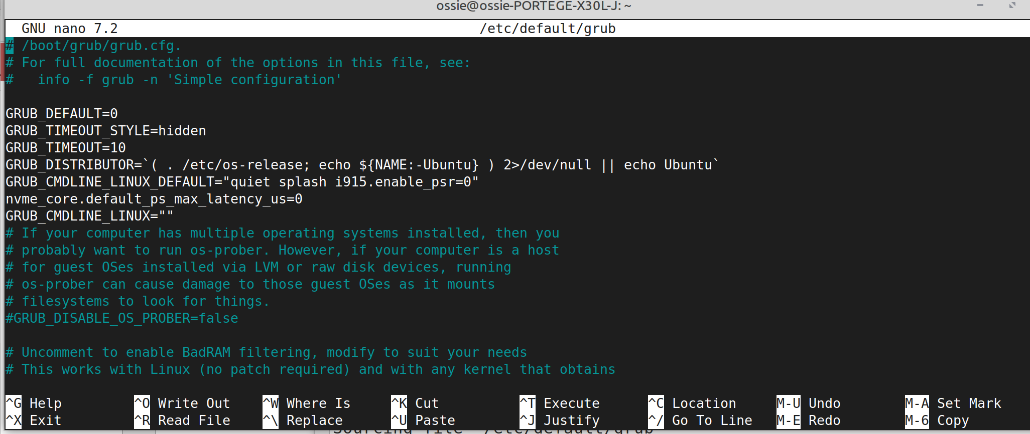

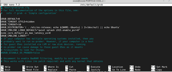

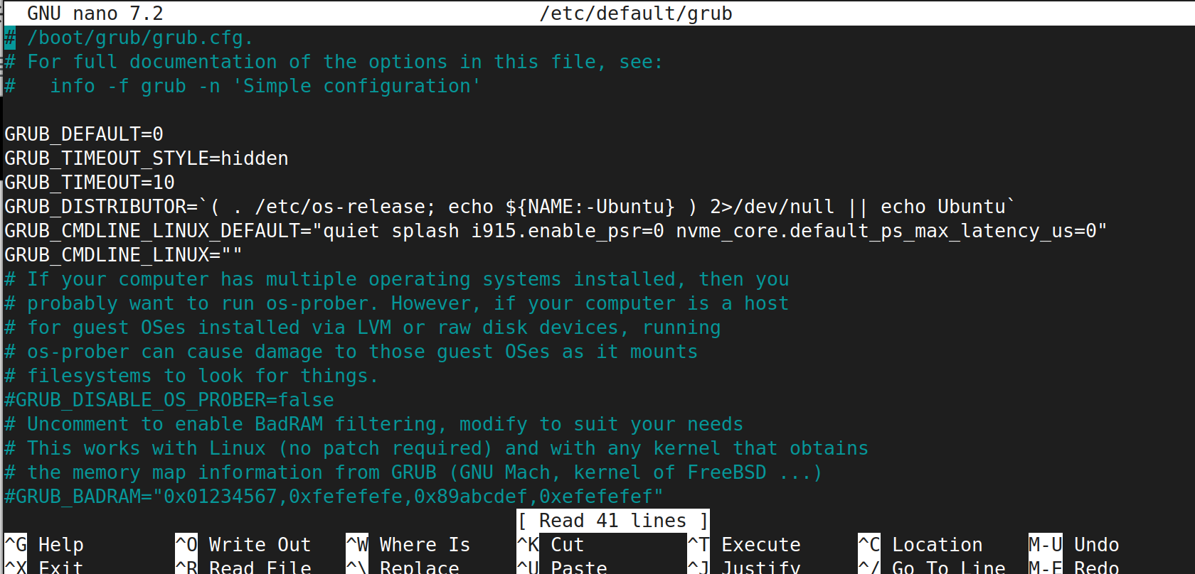

Sorry for the delay here is a pix of my Grub menu

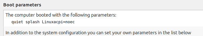

I think the following is how my pc boots.

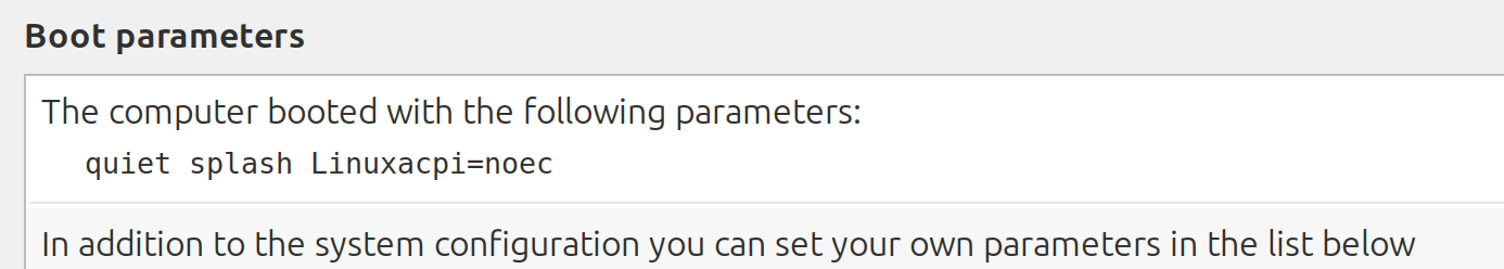

more info.
This appears to be lots of conflicting stuff. Due to my limited understanding I am scratching my head…

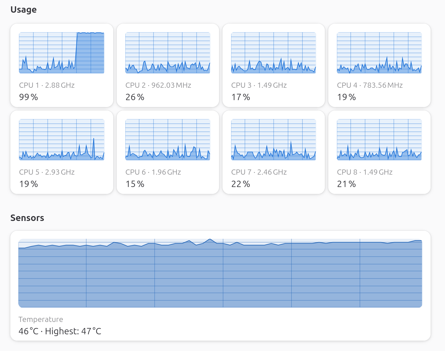

This is my CPU when power is disconnected and running on battery.

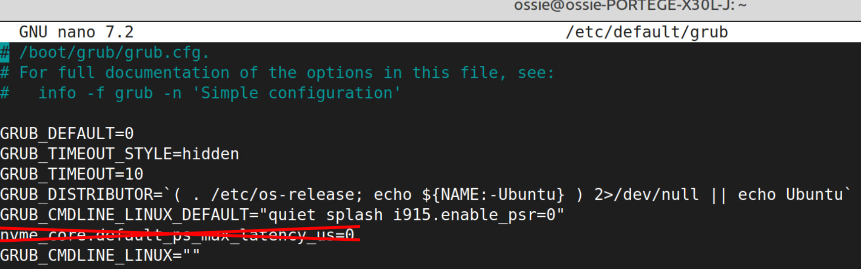

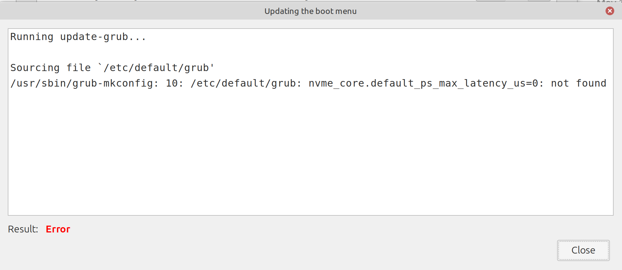

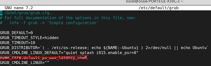

No worries @oswald_carter looks like you’ve already added i915.enable_psr=0 which is great. But there’s one issue with the file.
You’ve got nvme_core.default_ps_max_latency_us=0 on its own line, and that won’t work, it needs to be inside the quotes with the others, everything on the same line.
Out of curiosity, where did the nvme_core.default_ps_max_latency_us=0 come from? That’s an unrelated tweak for NVMe power state issues, just want to make sure you actually need it. Did you add it? It should be removed or reverted.
To fix this, open the file again:
sudo nano /etc/default/grub
Change the two lines so they become one line, exactly like this:
GRUB_CMDLINE_LINUX_DEFAULT="quiet splash i915.enable_psr=0 nvme_core.default_ps_max_latency_us=0"
Then delete the orphan nvme_core.default_ps_max_latency_us=0 line below it.
Press Ctrl+O then Enter to save, then Ctrl+X to exit nano. Then run:
sudo update-grub
Reboot, unplug the charger, and see if CPU1 still pegs at 98%. If it does, we’ll have to dig further. If it calms down, we’ve got it.

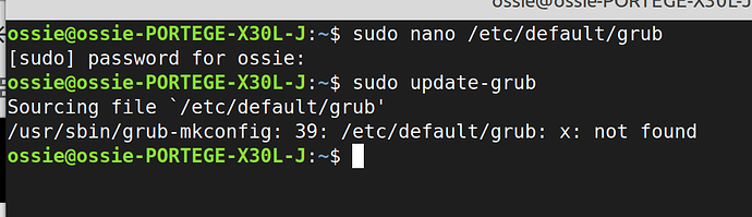

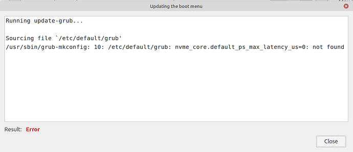

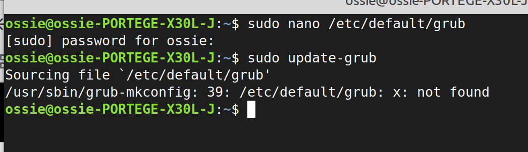

After completing the menu and trying to update this is what happened.

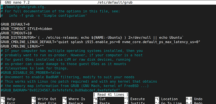

This is what my updated grub looks like.

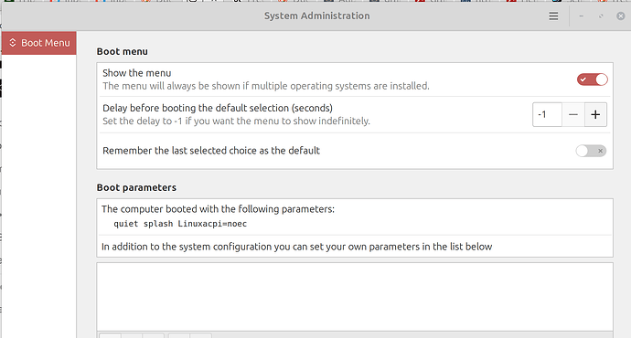

My system admin looks like this.
and this is not congruent with what I have done… I don’t think …

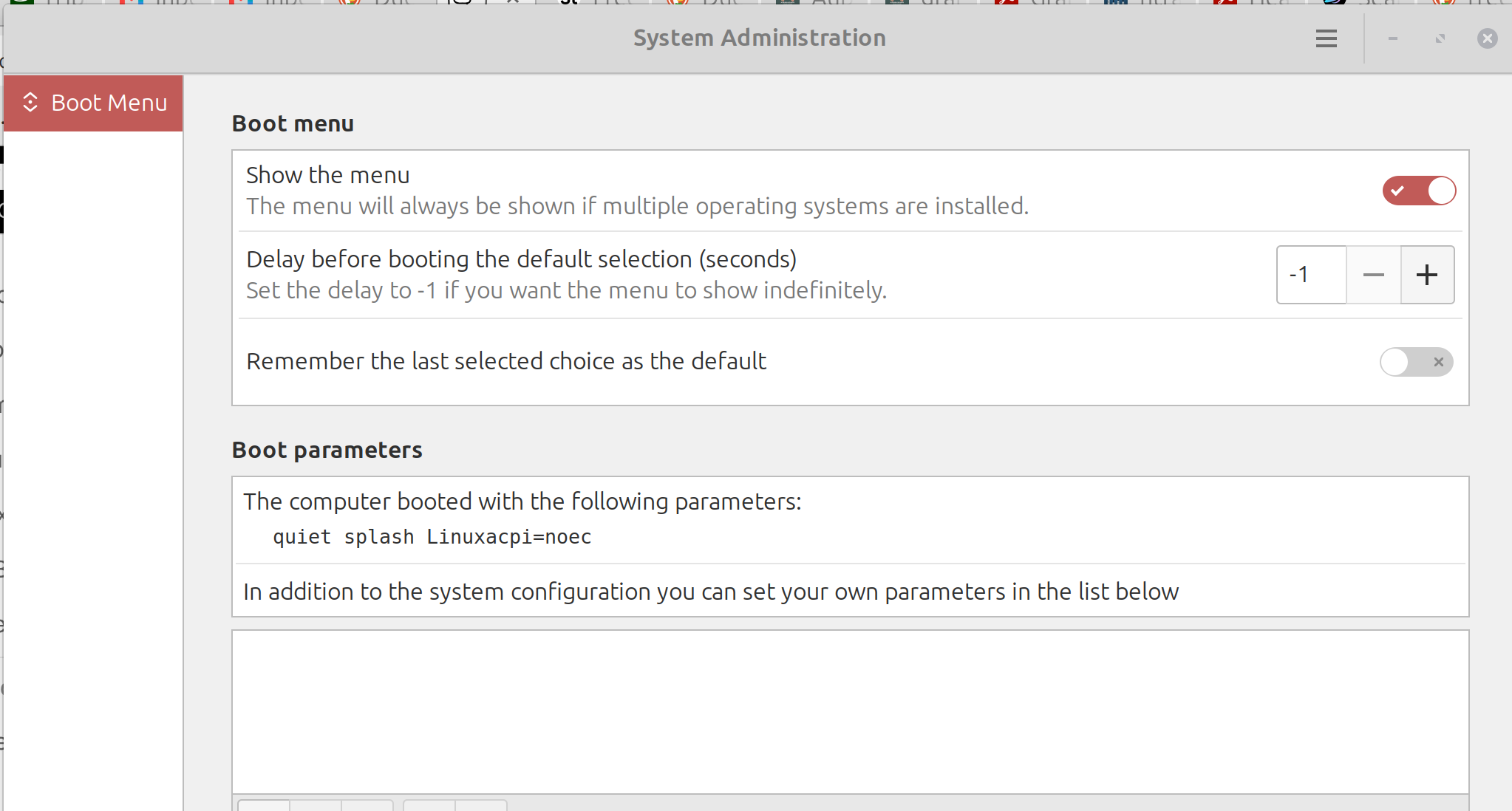

Two things @oswald_carter First, the file looks correct now, good job.
However, the update-grub is failing with that error 39/etc/default/grub: x: not found.
That usually means there’s a stray character or broken line somewhere in the file that bash can’t parse, so update-grub bailed out and didn’t actually apply your changes. That is the reason why your boot parameters screen still shows the old quiet splash Linuxacpi=noec instead of the new ones.
Can you paste the full contents of the file? Run this and paste the output:
cat /etc/default/grub
Also, that Linuxacpi=noec looks like a typo of acpi=noec from an earlier attempt, did you add that at some point? Once we can see the whole file we will be able to help you spot what’s breaking it.
