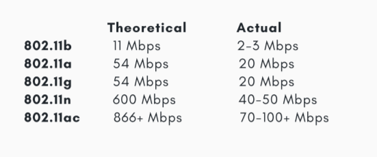

20 MHz with no HT means it’s using legacy 802.11a rates:
But you are on 5G, so it’s behaving like old 802.11a on 5 GHz, not modern WiFi (n/ac/ax). Strange.
