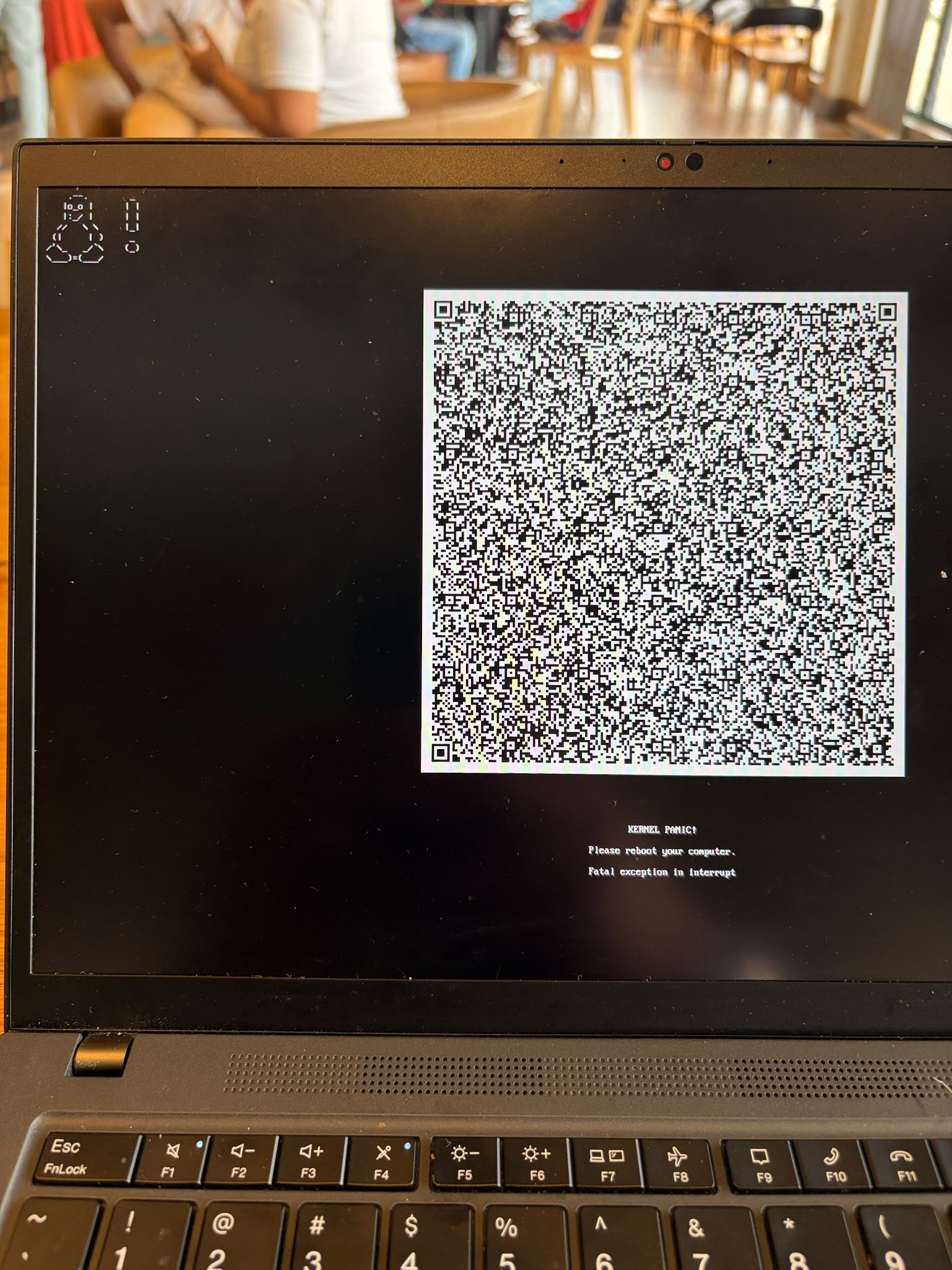

So first Linux kernel panic in a decade
Got hit with this after waking my ThinkPad today. DRM Panic screen (Tux plus a QR code) that kernels 6.12+ can show instead of a frozen console.

The QR code encodes a https://deb.li/panic#... URL containing the compressed kernel log. Scan it with your phone and open the full URL, and the page decodes the log in the browser. Note that the page tells you to reportbug to Debian. On Kali, file at bugs.kali.org instead.

Kernel panic - not syncing: Fatal exception in interrupt
The ath11k driver page-faulted while resuming from sleep. mac80211 restarted the radio, the driver sent a firmware command, and it touched a ring buffer that wasn’t mapped anymore because the chip hadn’t come back cleanly. It’s a known class of ath11k/WCN6855 resume bugs, and it’s intermittent: I’d suspended and resumed several times the weeks before without issues.
