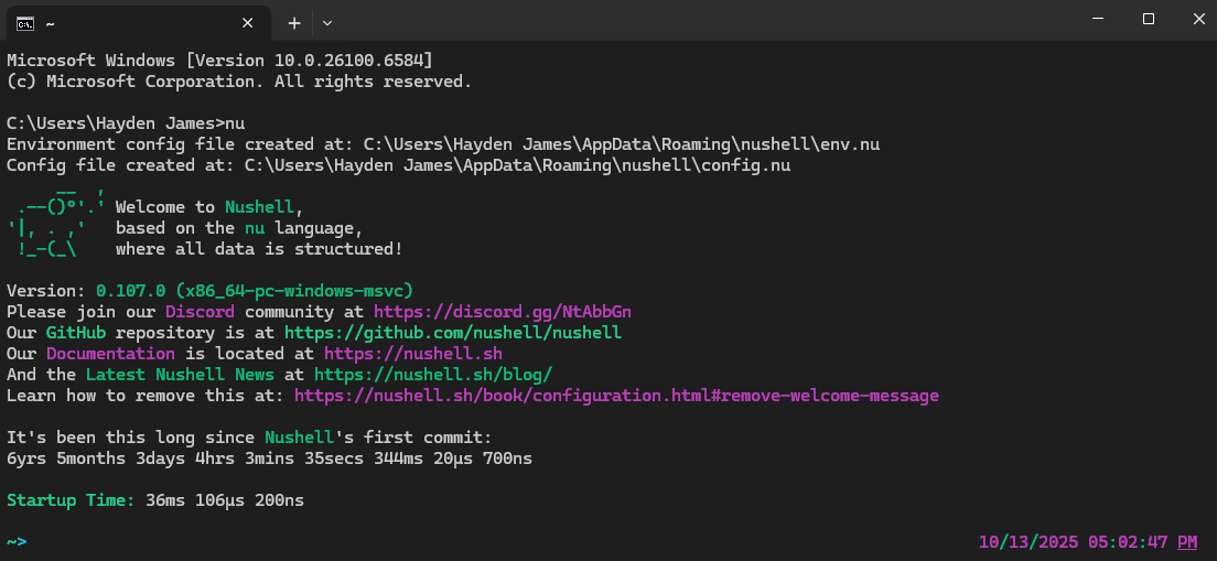

Nushell + rg, make your MSFT cli use tolerable
I loathe MSFT’s shells, but I recently ran across nushell. Wow! Finally a shell on Windows I can use. Commands like ls -a work. HUGE improvement. Coupling it with ripgrep helps me find things inside Mathematica notebooks when I think “Where did I put my notes on xyz?”. A typical session starts with opening a terminal window in some folder and then nu followed by rg xyz *.nb | more. Nushell alone was a game changer, with rg the improvement is exponential.
Unlike WSL (and similar), both nushell and rg run within Windows (natively): all windows paths and commands are available without mismatched filesystem interfaces to mess things up.
I still need to use Win 11, and this combo makes using its CLI tolerable. It might help you too if you want a low effort way to do Linux like things on Windows. Both commands provide various ways to install an exe. I compiled (Rust) nushell, and I probably used winget for ripgrep (a year or two ago). The only “hard” part was adding these commands to my executable path.
Finally, both are available on Win Mac and Linux, so they’re learn once and use everywhere.
