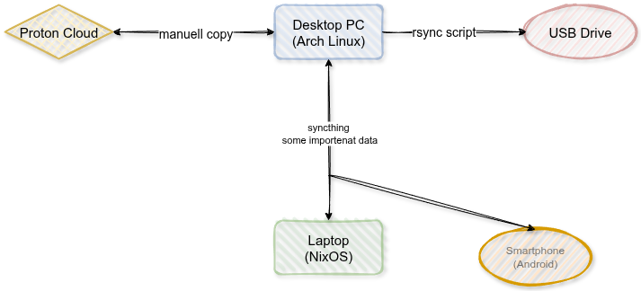

I do something like this, nothing special:
