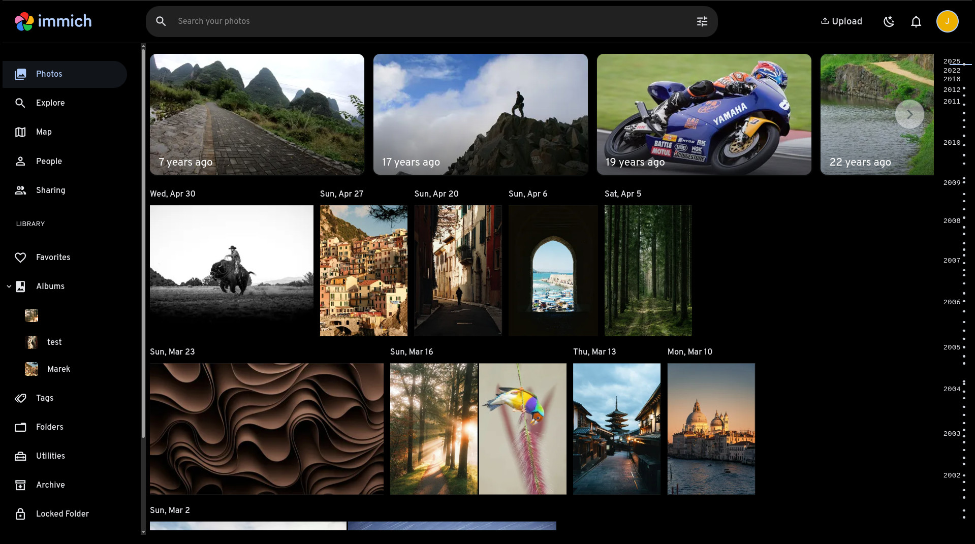

The majority of my paid cloud storage is images. Last year I found out about Immich for the first time:
Should be rewarding to finally get that in place.

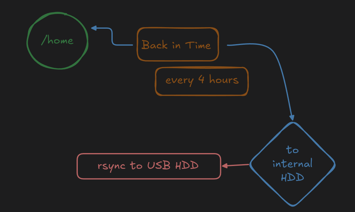

I use something like this
