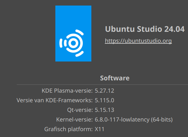

You might as well add Ubuntu-Studio. :slight_smile:
Hmm… According to Ubuntu Studio - Wikipedia Ubuntu Studio uses low-latency and not real-time kernel version.
Yes indeed :slight_smile:
You can see I haven’t touched the laptop in a while :innocent:
Linux 6.8.0-90-lowlatency
#91.1-Ubuntu SMP PREEMPT_DYNAMIC
Thu Nov 27 12:26:22 UTC 2025
x86_64 x86_64 x86_64
GNU/Linux
