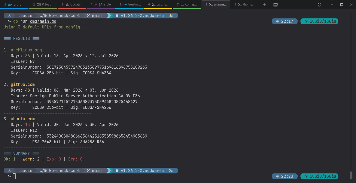

Hey community,

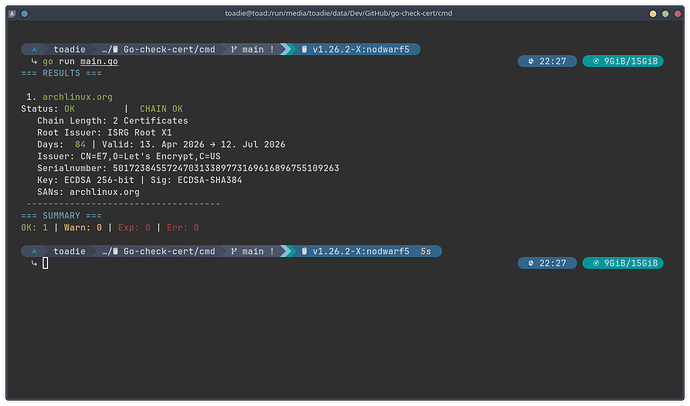

I’ve written a little certificate checker.
Maybe someone will find it useful, or maybe you have ideas for improvements or additions.

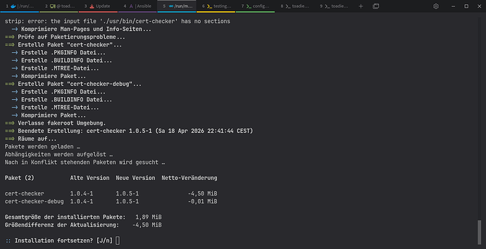

Sure thing. I still need to tweak the PKGBUILD script for the AUR. The binary is pretty large, and I want to compress it, just like the version on GitHub.

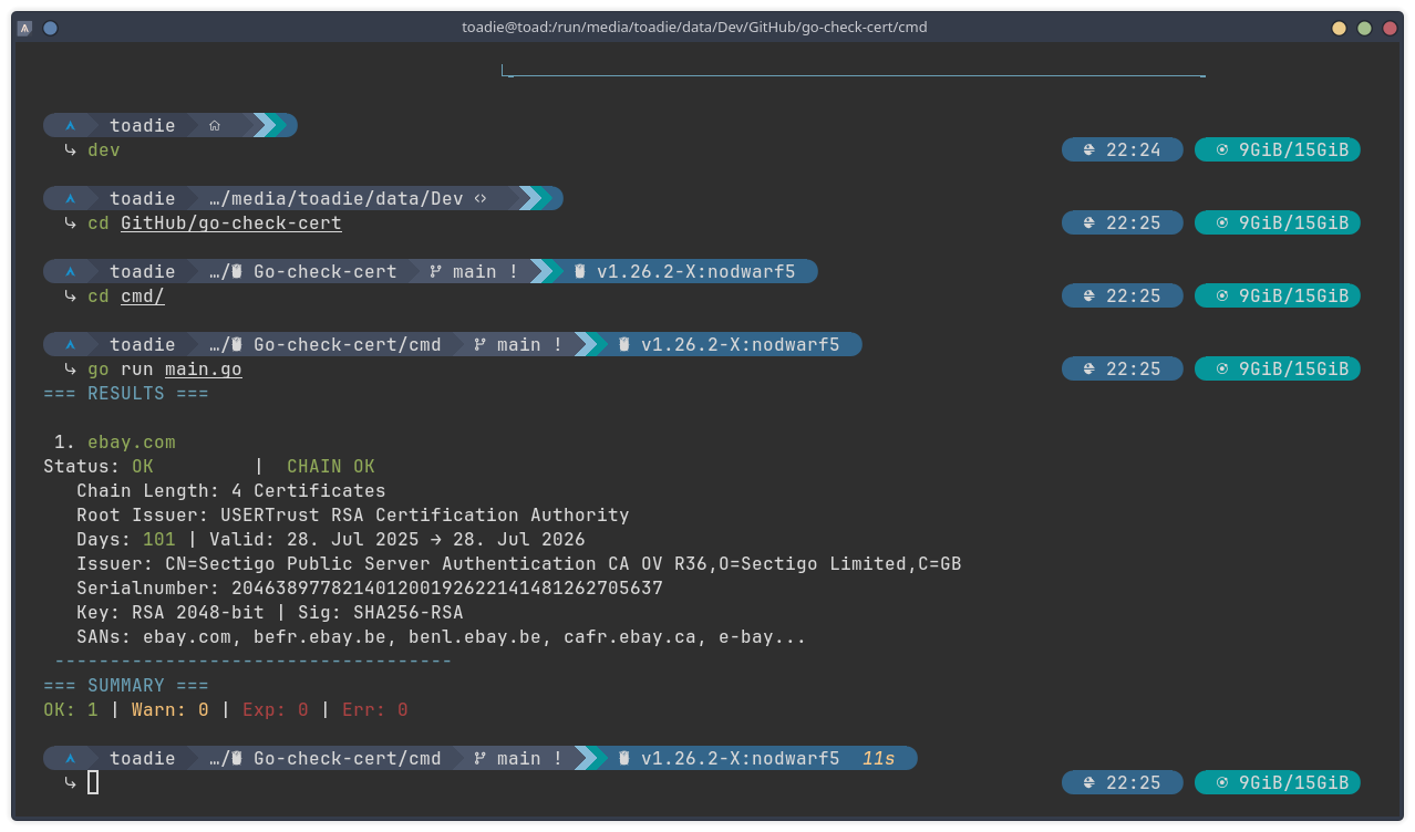

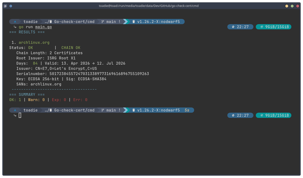

Unfortunately, I didn’t have much time today. Still, here are two additional pieces of information as requested.
What do you think of a simple version and a version with more information?
Github and AUR are updated
Looks very nice to me!

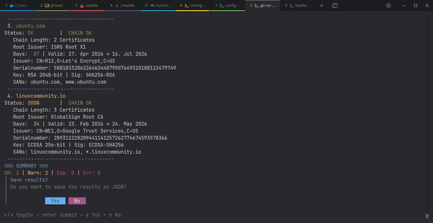

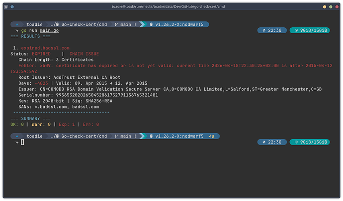

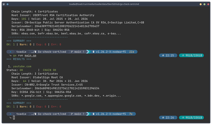

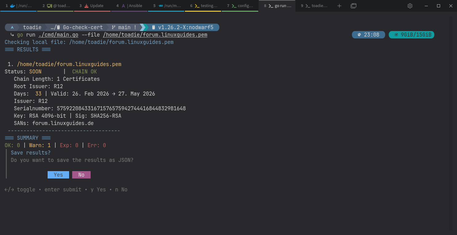

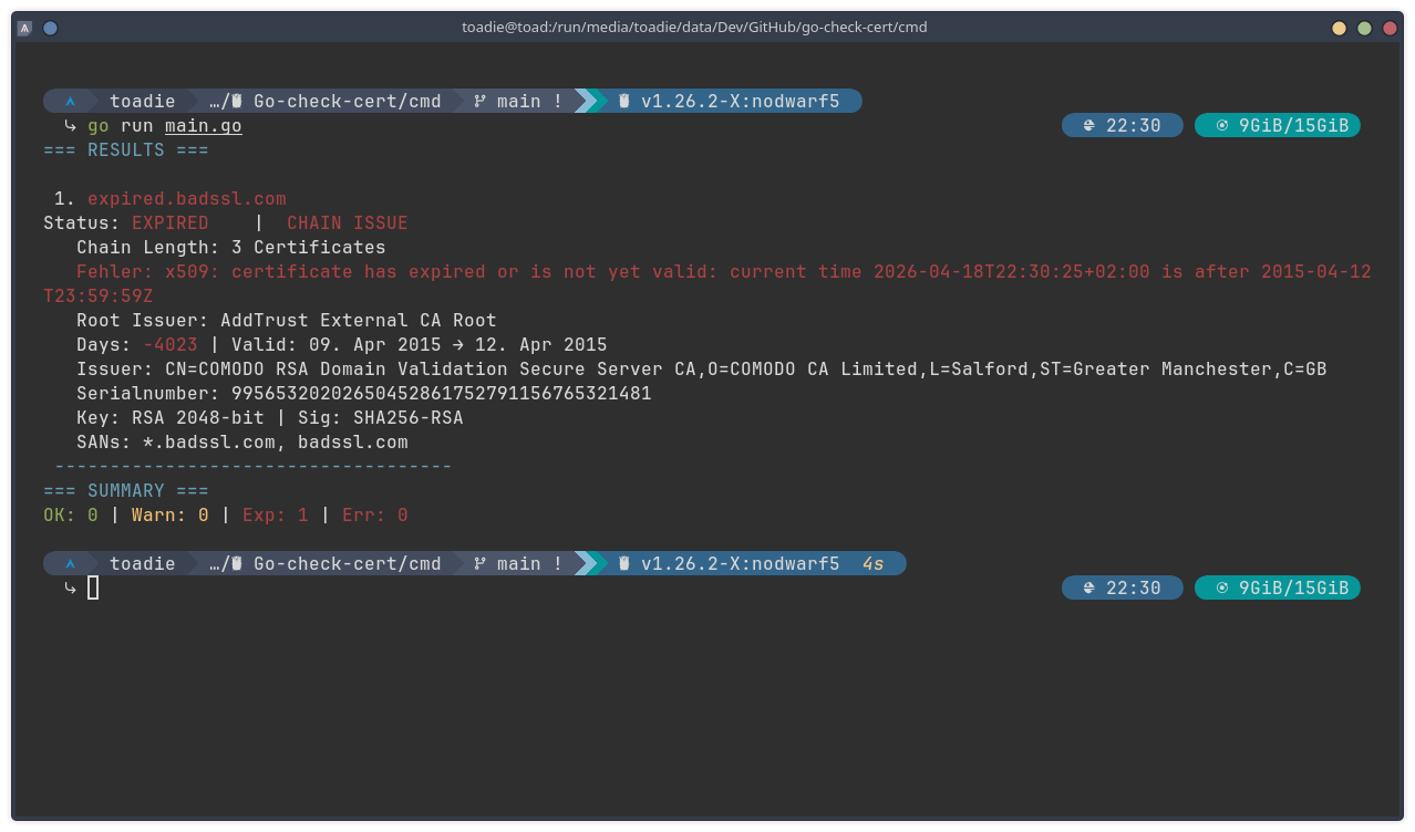

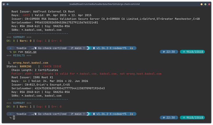

Now it’s possible to save the output as a JSON file:
  "generated_at": "2026-04-19T22:06:17+02:00",
  "total_count": 4,
  "results": [
      "URL": "archlinux.org",
      "Issuer": "CN=E7,O=Let's Encrypt,C=US",
      "Subject": "archlinux.org",
      "SerialNumber": "501723845572470313389773169616896755109263",
      "NotBefore": "2026-04-13T11:59:12Z",
      "NotAfter": "2026-07-12T11:59:11Z",
      "DaysRemaining": 83,
      "Status": "OK",
      "Error": null,
      "KeyAlgorithm": "ECDSA",
      "KeySize": 256,
      "SignatureAlgorithm": "ECDSA-SHA384",
      "SANs": [
        "archlinux.org"
      "ThumbprintSHA1": "b36e7e96c849673e16903dd2a17c684a2ac0be02",
      "ThumbprintSHA256": "7b76334e7e52028a90f09baa408f1a2a71a714369902f146d8a2a742150db3a1",
      "ChainLength": 2,
      "IsChainComplete": true,
      "ChainError": "",
      "IsSelfSigned": false,
      "RootIssuer": "ISRG Root X1"
      "URL": "github.com",
      "Issuer": "CN=Sectigo Public Server Authentication CA DV E36,O=Sectigo Limited,C=GB",
      "Subject": "github.com",
      "SerialNumber": "39557711522153605937503944820825465427",
      "NotBefore": "2026-03-06T00:00:00Z",
      "NotAfter": "2026-06-03T23:59:59Z",
      "DaysRemaining": 45,
      "Status": "SOON",
      "Error": null,
      "KeySize": 256,
      "SignatureAlgorithm": "ECDSA-SHA256",
      "SANs": [
        "github.com",
        "www.github.com"
      "ThumbprintSHA1": "ab58ea128ba92ca69a31b36b4e545653eed2a6cf",
      "ThumbprintSHA256": "9716d39441ca651c51be78e969ca385ec213ec17715b8c91f01ee652f90fc62c",
      "ChainLength": 3,
      "ChainError": "",
      "RootIssuer": "USERTrust ECC Certification Authority"
      "URL": "ubuntu.com",
      "Issuer": "CN=R12,O=Let's Encrypt,C=US",
      "Subject": "ubuntu.com",
      "SerialNumber": "588183328622646244879507649310188122479749",
      "NotBefore": "2026-04-17T04:13:36Z",
      "NotAfter": "2026-07-16T04:13:35Z",
      "DaysRemaining": 87,
      "Status": "OK",
      "Error": null,
      "KeyAlgorithm": "RSA",
      "KeySize": 2048,
      "SignatureAlgorithm": "SHA256-RSA",
      "SANs": [
        "ubuntu.com",
        "www.ubuntu.com"
      "ThumbprintSHA1": "f39b552a2183a34263e8566cc02eece120cc3996",
      "ThumbprintSHA256": "f3a90c7328568d1e032c0202b5ed49c9a5327e6650e0335ce182a81a0896ff0e",
      "ChainLength": 2,
      "ChainError": "",
      "URL": "linuxcommunity.io",
      "Issuer": "CN=WE1,O=Google Trust Services,C=US",
      "Subject": "linuxcommunity.io",
      "SerialNumber": "289311228209441141257262774674593578366",
      "NotBefore": "2026-02-23T07:36:54Z",
      "NotAfter": "2026-05-24T08:36:47Z",
      "DaysRemaining": 34,
      "Status": "SOON",
      "Error": null,
      "KeySize": 256,
      "SANs": [
        "*.linuxcommunity.io"
      "ThumbprintSHA1": "5a2ca02b7195d0e978779dae6b07fe6954673e48",
      "ThumbprintSHA256": "aa8534a227cf12c73c0fadbc37530d9d172c5ad21c7477815e80a9eca4cc86d5",
      "ChainLength": 3,
      "ChainError": "",
      "RootIssuer": "GlobalSign Root CA"

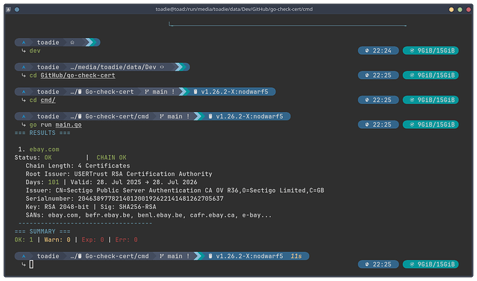

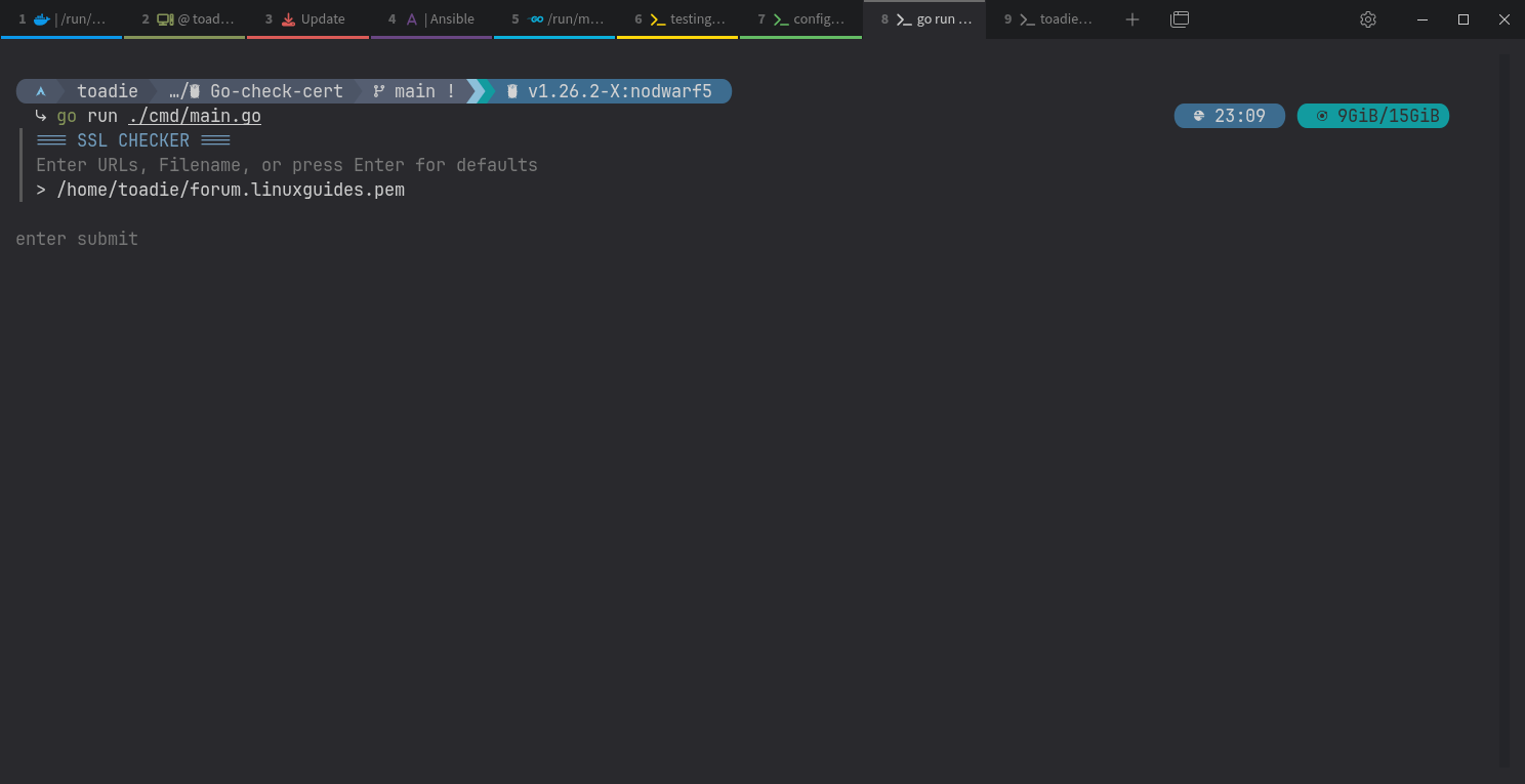

A new version is available.
Detailed documentation will follow in the coming days.
In short, you can do the following:
  • Check a list of URLs
  • Check individual URLs (comma-separated)
  • Check local certificate files
  • Save information as JSON
flag mode
or interactive

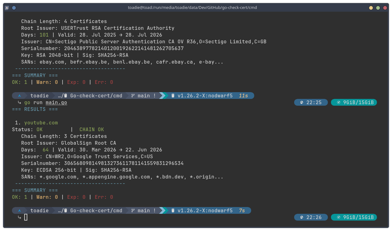

Update (I try to write this post without translator - beware of bad english :laughing:)
I wanna share this with you.
Old code (tradional way)
01
Parallel processing or concurrency how it names in Go
02
Both methods are processing the same 20 URLs
The difference is massiv.
