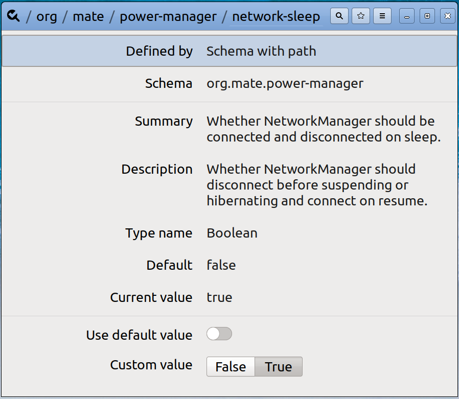

You might try this:
Thanks TKN I’ll try this.
W
Now… I did as suggested, TKN.
My observation:
If it gets into suspend by itself after some time, then I get the password window and can re-enter the desktop
If I ASK for suspend using the shutdown, then I get the password window but no possibility to enter password and re-enter the desktop
So… two different behaviour.
