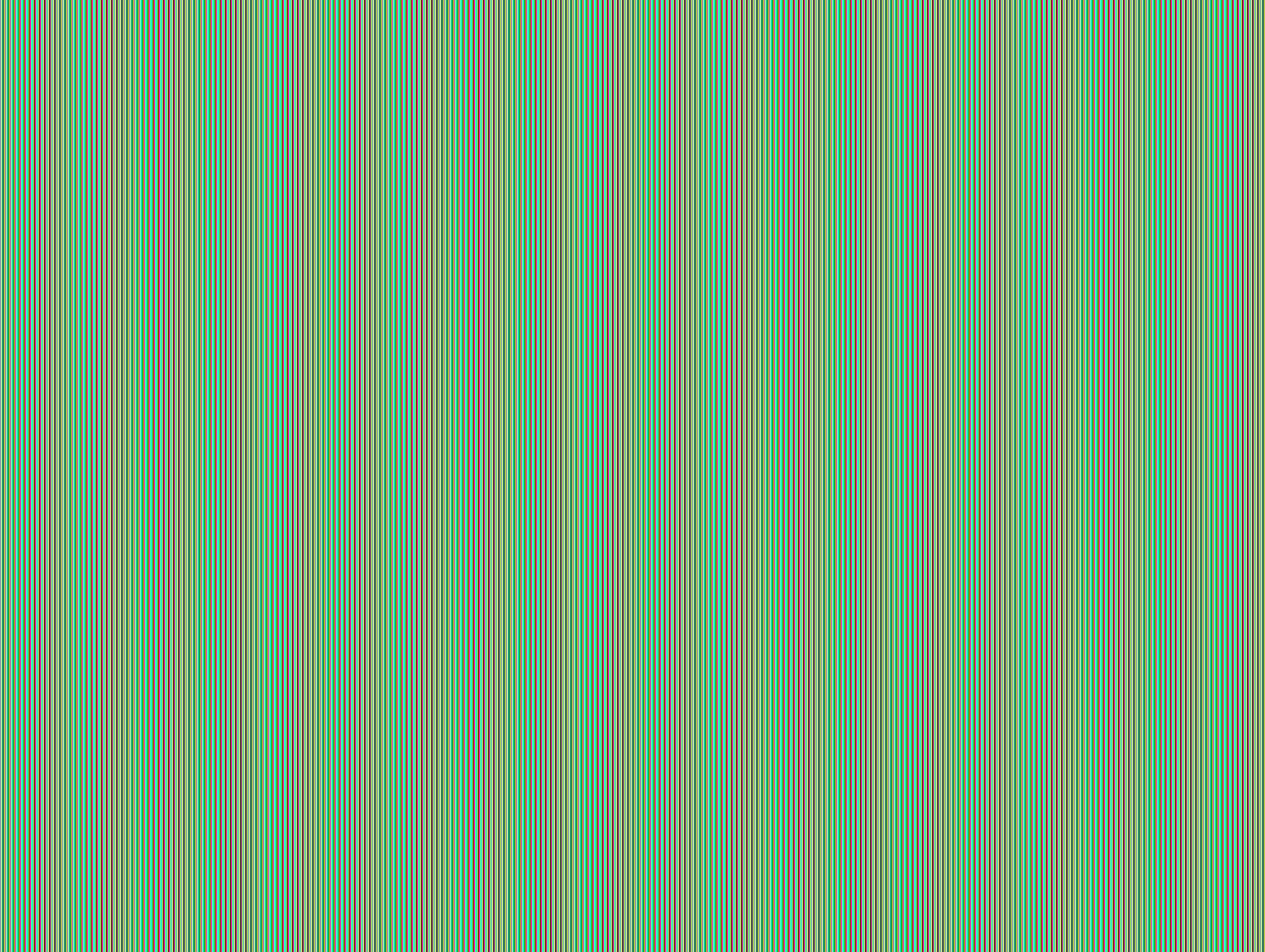

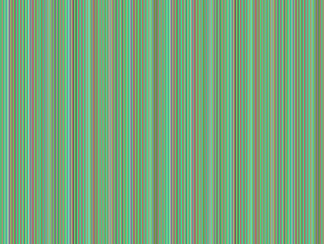

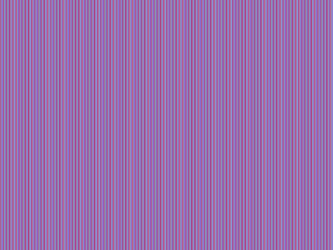

Shortly after starting Linux, the text on the display looks encrypted and stops working
When my laptop is running for some time, suddenly the writing becomes encrypted type, all the DE icons are hidden. The memory icons on the display also become blurred, no click works. Turning it off and on with the stop switch is fine.
I used to use Linux Xubuntu and Ubuntu earlier, now Linux Mint. I have seen the same problem in all of them. What can I do to get the right solution.plz help me.
