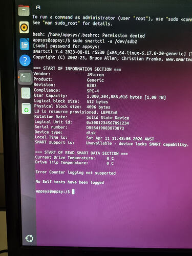

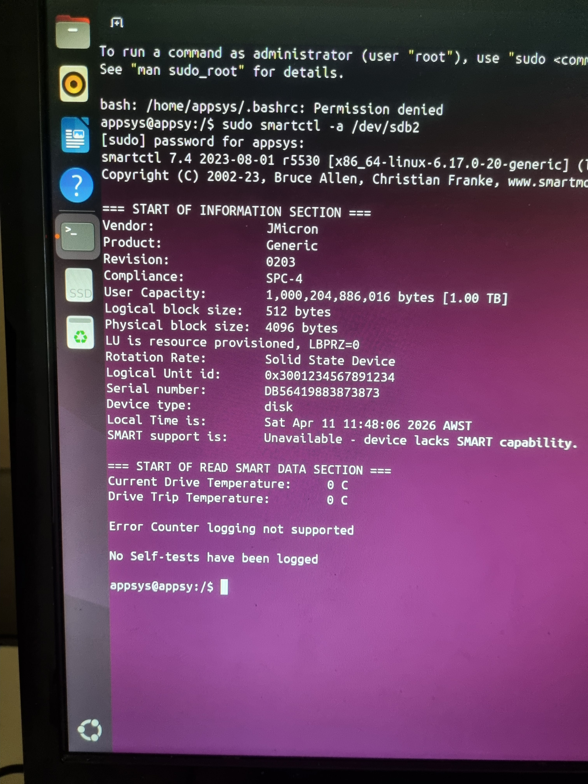

How kts connected seems to be blocking smartctl.
If you can still access your files, I’d back everything up now!
In the screenshot that JMicron Generic result means smartctl is seeing your USB-to-SATA bridge chip, not the actual SSD behind it. That’s why SMART shows as unavailable and the temps are 0C.
The adapter or something is blocking the health data from getting through.

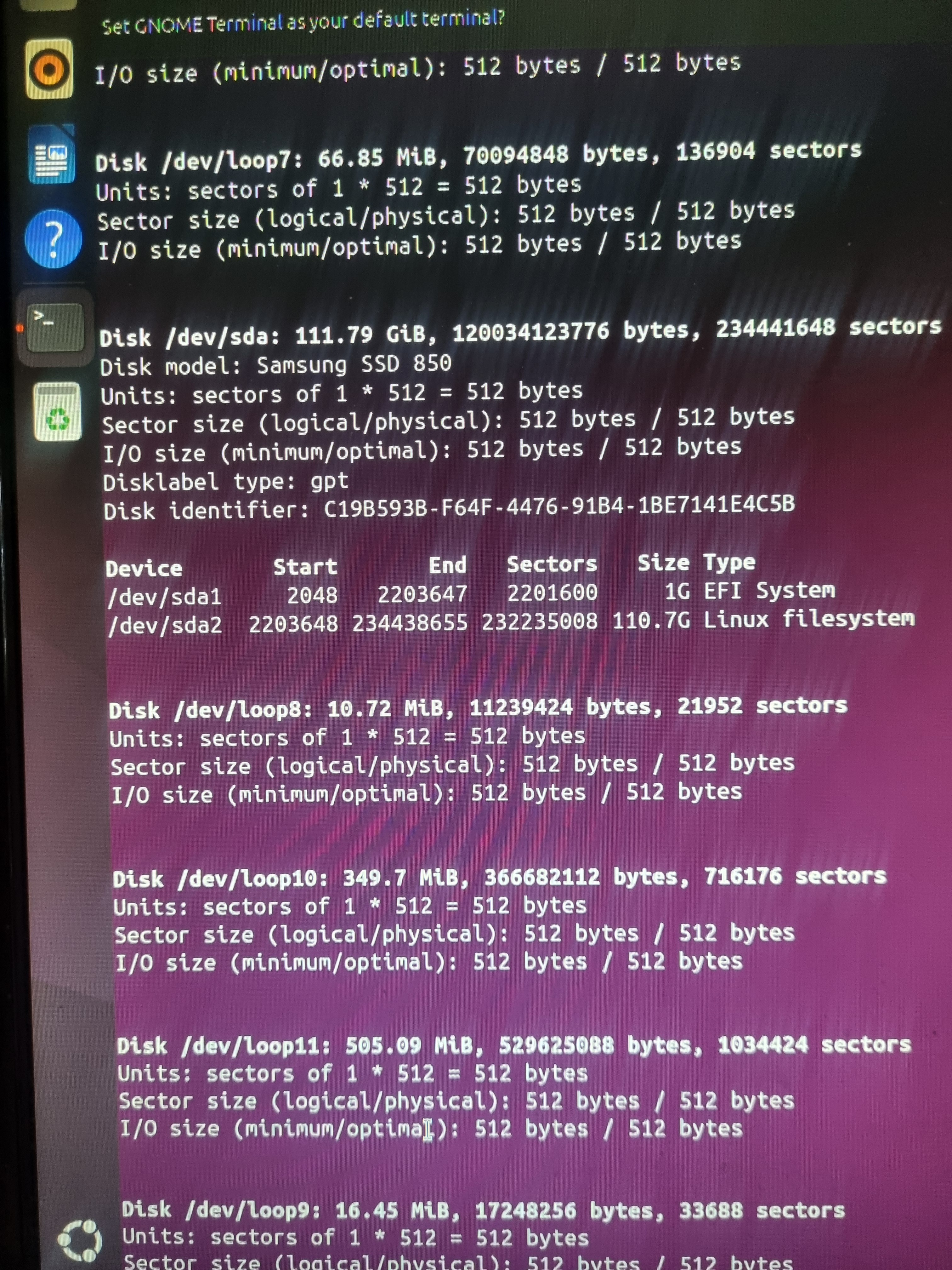

Can you show us the result of sudo fdisk -l
I presume it is the info about the device that is required

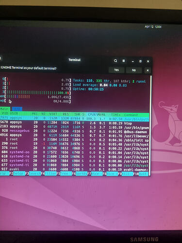

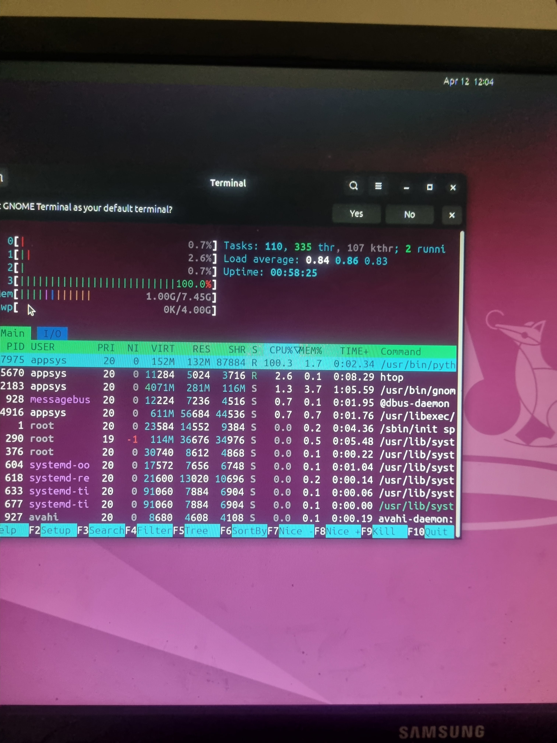

Is any of this info significant, please? CPU usage seems to fluctuate wildly between 3% and 100% Processing: 1000029235.jpg…
Your actual drive is the Samsung SSD 850 at /dev/sda. That JMicron device you ran smartctl on earlier was something external plugged in via USB, not your boot drive.
Try sudo smartctl -a /dev/sda and that should give you the real SMART data for your Samsung. That’ll tell us if the drive is healthy or on its way out.

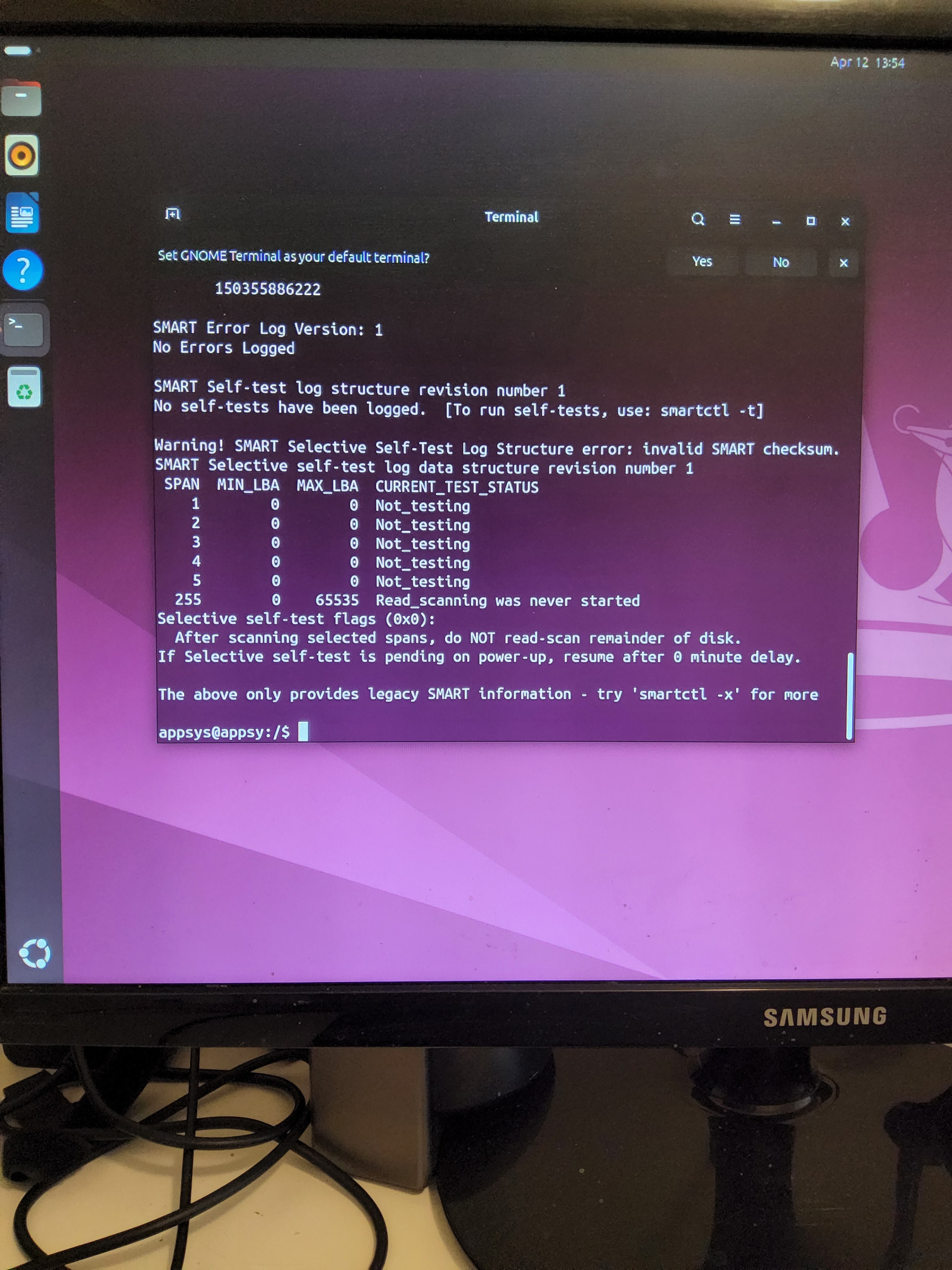

Results of smartctl scan:
I ran the smartctl -H test and the verdict was that the SSD is in good health. I guess that is good news but, it doesn’t address the main problem

That’s the tail end of the output, the good stuff is at the top.
Can you scroll up or run sudo smartctl -a /dev/sda | less so you can scroll through it?
hm, or even sudo smartctl -a /dev/sda > ~/smart_result.txt and then paste the contents of that file.
Looking for the overall health status especially things like Reallocated_Sector_Ct, Wear_Leveling_Count, and Power_On_Hours.

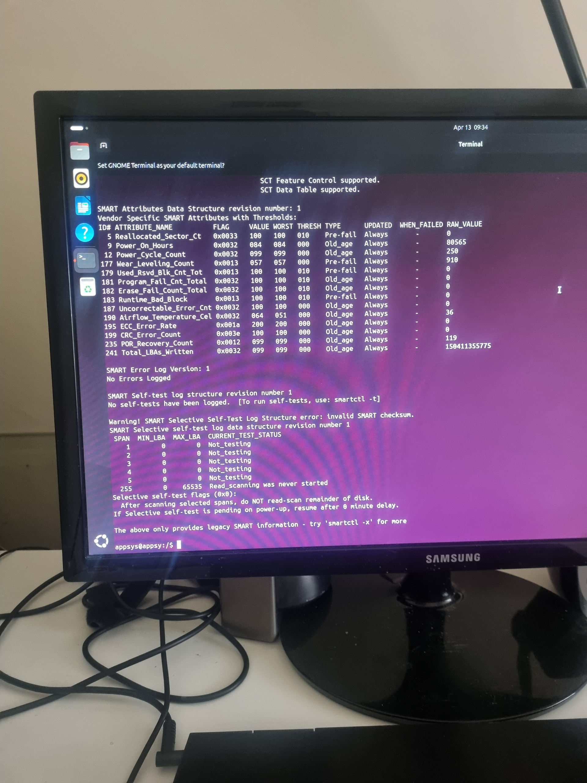

I hope this helps:
