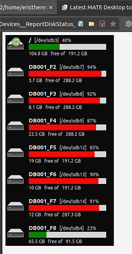

Self-challenge to report disks like Windows

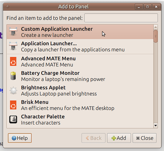

Reported need:
Challenge to self:
See what I can do, so …
The following is a snapshot of what I was able to come up with:
As can be seen from the end of my script, the intent was to use YAD’s HTML capability to present that as a pop-up, but, my version on UbuntuMATE 22.04 LTS doesn’t seem to work. I do plan to test it on my UbuntuMATE 26.04 test install soon.
So … maybe someone can turn this into an actual Panel App, if the HTML can be easily wrapped into some other tool generator. :slight_smile:
I offer below the SHELL script used to create that HTML page. Admittedly, it is a hack, but I think it is decent enough!
  • I used the supplied image to create my own transparent icon for the “basic” drive.
  • I used the SVG icon artwork for the Ubuntu MATE roundel, so that “conditions” used to validate the OS type, it goes thru a case statement to choose which icon to overlay to represent that OS.
  • I did not incorporate logic for network drives because I don’t have any, but I looked at the tools to do so, and if someone would share a report for some commands to have the output that would be parsed, I could work out that additional logic to handle the case for network-mounted drives as well.
Artwork Ref:
    [Edit:   revised logic for portability]

echo "
</body>
</html>
" >> ${displayHtml}
# Display in YAD
#yad --html --title="Disk Usage" --width=400 --height=150 --center --no-buttons < ${displayHtml}
#sudo -i -u ${primaryUserID} firefox --new-tab ${displayHtml}
#su - ${primaryUserID} -c "firefox --new-tab ${displayHtml}"
echo -e "\n\t GENERATED: Report created as HTML file ..."
ls -l ${displayHtml} | awk '{ printf("\t %s\n", $0 ) }'
For on-demand operation, you can create custom application launcher for a wrapper script. The wrapper script would invoke your html generator and pass html file to a simple html viewer.
Some ideas regarding html viewer can be found here:
P.S. Could not resist to mention

Session log of first run:
        (updated to reflect most recent code version offered above)
ericthered @ OasisMega1 : ~
$ ~root/Devices__ReportDiskStatus.sh
	 mkdir: created directory '/home/ericthered/.config/icons'
	 mode of '/home/ericthered/.config/icons' retained as 0775 (rwxrwxr-x)
	 ownership of '/home/ericthered/.config/icons' retained as ericthered
	 CONFIRMED: Setup ... required icon repository created at '/home/ericthered/.config/icons' ...
	 drwxrwxr-x 2 ericthered ericthered 4096 Apr 14 13:22 /home/ericthered/.config/icons
	 CONFIRMED: Setup ... required icon saved at '/home/ericthered/.config/icons/Ubuntu__MATE_Roundel.svg' ...
	 -rw-rw-r-- 1 ericthered ericthered 5890 Apr 14 13:22 /home/ericthered/.config/icons/Ubuntu__MATE_Roundel.svg
	 CONFIRMED: Setup ... required icon saved at '/home/ericthered/.config/icons/Ubuntu__Standard_Roundel.svg' ...
	 -rw-rw-r-- 1 ericthered ericthered 699 Apr 14 13:22 /home/ericthered/.config/icons/Ubuntu__Standard_Roundel.svg
	 CONFIRMED: Setup ... required icon saved at '/home/ericthered/.config/icons/DRIVE__Local.png' ...
	 -rw-rw-r-- 1 ericthered ericthered 1193 Apr 14 13:22 /home/ericthered/.config/icons/DRIVE__Local.png
	 -rw-rw-r-- 1 ericthered ericthered 9811 Apr 14 13:22 /home/ericthered/Downloads/Devices__ReportDiskStatus_report.html
Subsequent runs:
	 -rw-rw-r-- 1 ericthered ericthered 1193 Apr 14 13:24 /home/ericthered/.config/icons/DRIVE__Local.png
	 -rw-rw-r-- 1 ericthered ericthered 9811 Apr 14 13:24 /home/ericthered/Downloads/Devices__ReportDiskStatus_report.html
