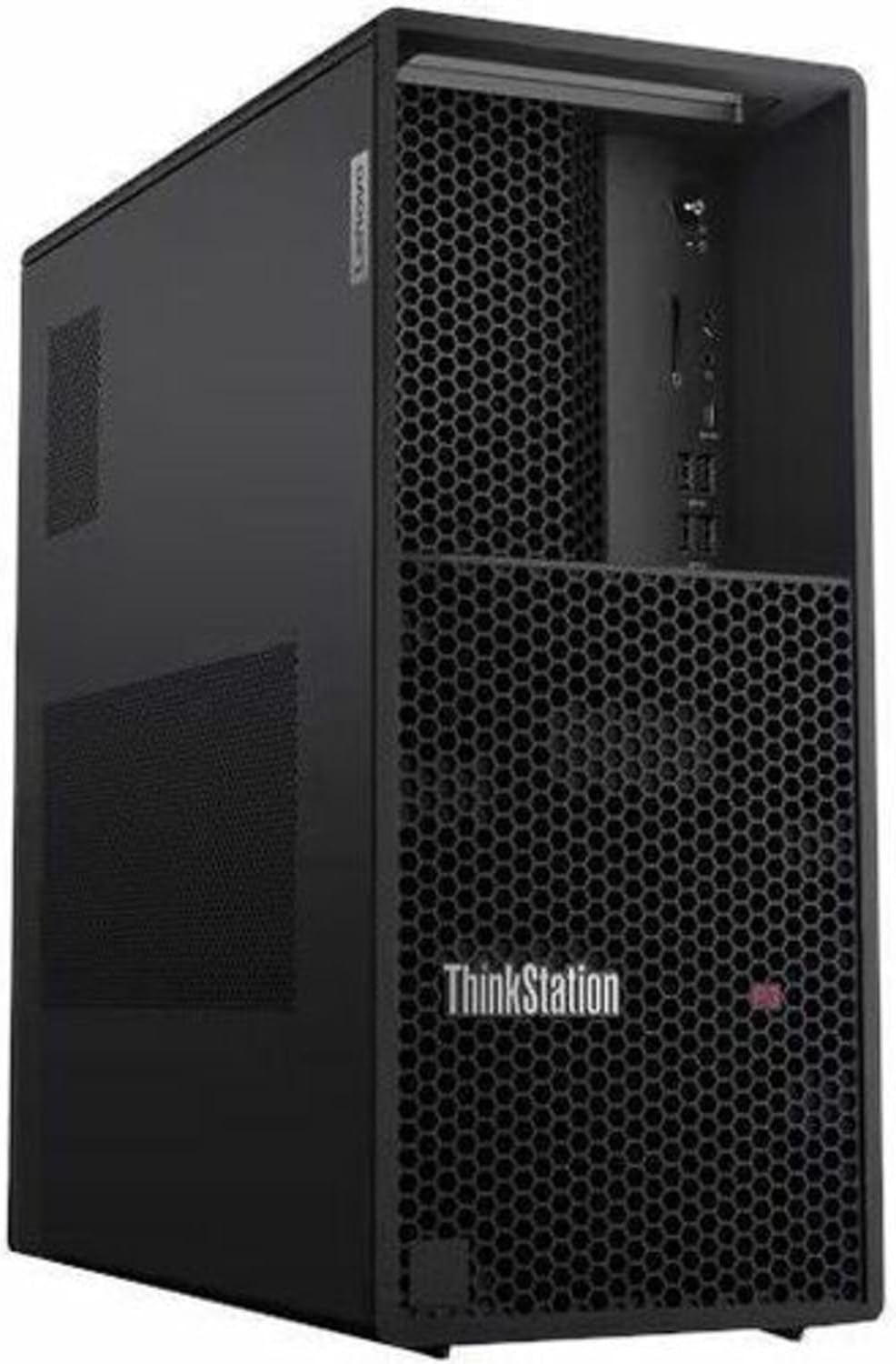

But they have this THINKSTATION P3 Tower listed on Amazon for $2,127.74. It has an Intel P9 cpu and while pricy, I don’t have to load it and it should serve me for years to come with enough power to hopefully run some AI local:
Is there any downside that anyone sees to this choice?

I strongly discourage buying PCs from Amazon except from the official manufacturer’s store. So, for example, I purchased a Dell for someone’s office earlier this year, but it’s from Dell’s Amazon store/account.
This is Lenovo and Dell on Amazon. It looks like that link you posted is also from Lenovo’s store but says unavailable. I find, the stores on Amazon listings to be like that a lot as well as often errors on specs, etc. So just be careful, buy items with reviews, and copy and paste the SNs and cross-check specs.
Beyond that, prepare for either used, tampered, or refurbished units being sold as new.

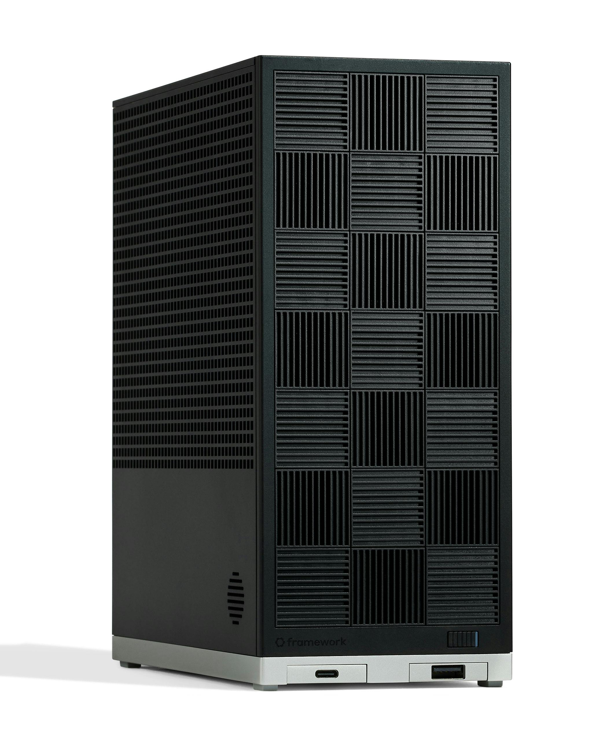

$2 is a very large budget, especially with a focus on Linux. You should also consider System76 and Framework:
I think you get a better bang for your buck for Linux-focused hardware.
Thanks so much Haden! I had not heard of those choices.

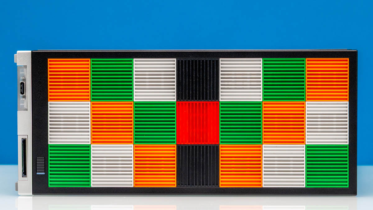

The Framework seem pricy, but I have not seen other AMD Ryzen AI CPU builds to compare it to. As I say, “You never get more than you pay for.” - sometimes you get less, but never more. Buy once, cry once. I would rather buy more than I need instead of having to spend the same money twice because I didn’t buy enough to start with. I have built/assembled every desktop I have ever had since my first 386sx, so the assembly shouldn’t be a problem for me.
I’m contemplating their mid-grade configuration with around $500 in custom configuration choices. Some I probably won’t ever use, but I don’t want to need something I didn’t get and have to add it later should a need for it arise. I want to build and forget about it, use it an not tinker with it:
Configuration $2,496.00
System: Ryzen™ AI Max+ 395 - 64GB
Storage: WD_BLACK™ SN850X NVMe™ - M.2 2280 - 1TB
CPU Fan: Noctua - NF-A12x25 HS-PWM
Power Cable: AC Cable - C13 - US/CA
Customization
Left Panel: Left Panel - Translucent $54.00
3 x Tile: Tile Pack - Vertical - Black $42.00
Tile: Tile - Framework $7.00
Tile: Tile - AMD $7.00
Expansion Cards
USB-C (Aluminum) $12.00
USB-C (Red) $12.00
USB-C (Black) $12.00
USB-C (Gray) $12.00
USB-C (Translucent Black) $12.00
USB-C (Translucent Orange) $12.00
USB-A $12.00
MicroSD (2nd Gen) $25.00
Ethernet $51.00
SD $35.00
Audio $25.00
1TB (1st Gen) $169.00
Accessories
Framework Screwdriver Included
Product Price $2,995.00
On second thought, I reconfigured to max out 6 of the USB-A ports as well. Better too many than to have to find a USB-C cable to adapt some old school devices I might want to plug in someday.
Yesterday, I happened to read a review of the Framework Desktop:
