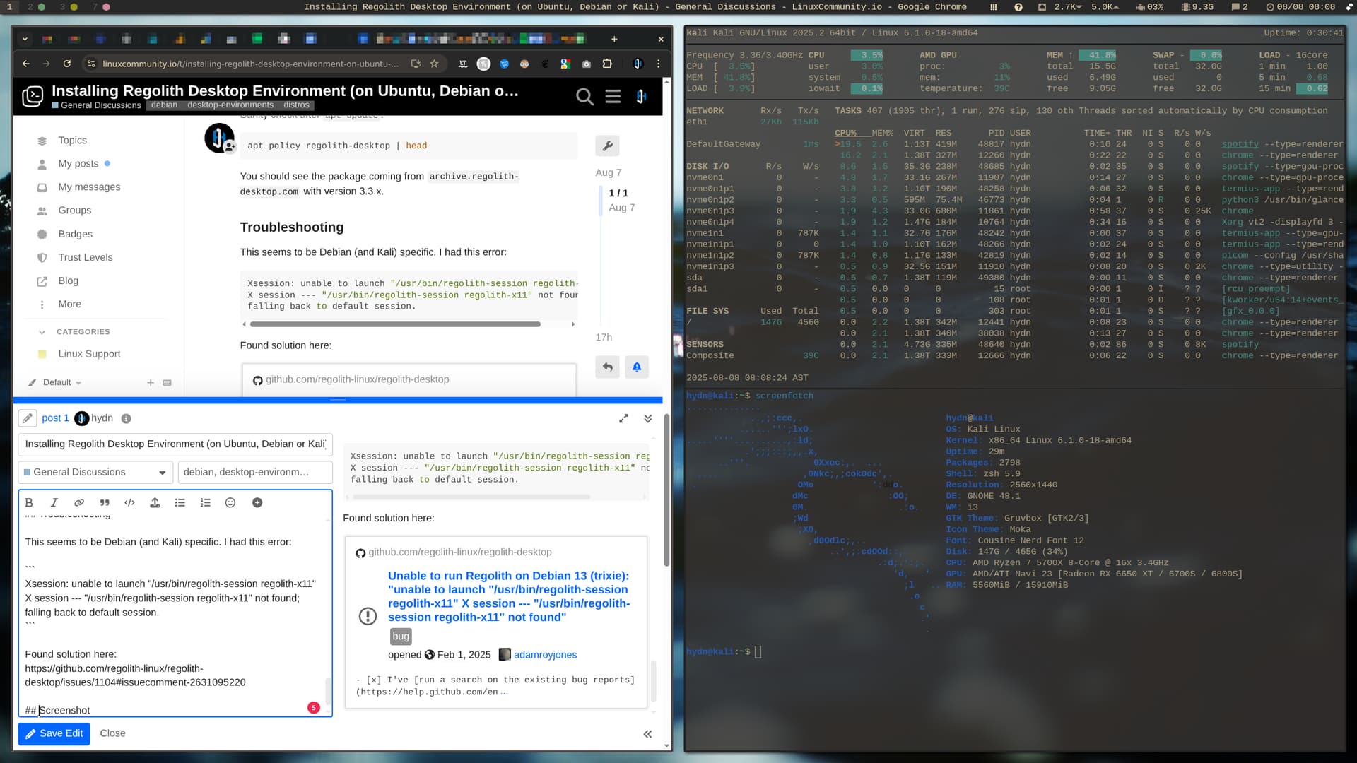

This seems to be Debian 13 (or Kali via deb testing) specific. I had this error:
Xsession: unable to launch "/usr/bin/regolith-session regolith-x11"
X session --- "/usr/bin/regolith-session regolith-x11" not found;
falling back to default session.
Found solution here:
Screenshot
