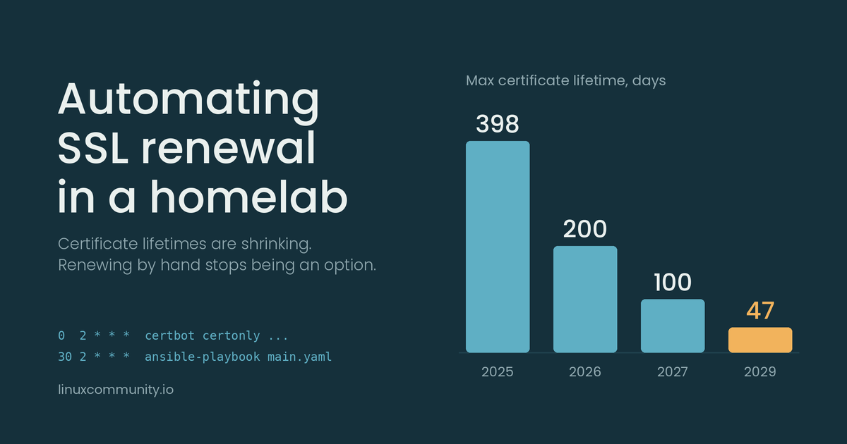

What SSL Certificate Changes are Coming?
In case you haven’t heard, the maximum lifetime of SSL Certificates will be changing, rather drastically, over the next three years. I’ll quickly summarize the changes, but I would recommend giving this article from Digicert a read through.
As of March 15, 2026, the maximum lifetime for a newly acquired certificate is 200 days, down from 398 days. Next year it will drop to 100 days, and finally in 2029, it will be down to 47 days.
The article that I linked above goes into some reasons for why 47 days was chosen and why the lifetime is reducing in general. There are some valid reasons given; my opinion is that I generally disagree with this change. I’d love to hear why (or if) you agree with the changes and what you think the impact will be.

So, what is happening? There are two parts to this “beast”:
  1. A cron job running at 2am that attempts to rotate the certificate, if it is close to expiring
0 2 * * * root certbot certonly --manual --keep-until-expiring --preferred-challenges=dns --manual-auth-hook /etc/letsencrypt/renewal-hooks/dns-authenticator --manual-cleanup-hook /etc/letsencrypt/renewal-hooks/dns-cleanup --deploy-hook /etc/letsencrypt/renewal-hooks/deploy-trigger -d '*.projecttiy.com' >> /dev/null 2>&1
  1. A cron job on another box running at 2:30am that actually rotates the certificate for each service and box, if it has been rotated
30 2 * * * cd /home/benjamin/playbooks/rotate_wildcard_certificate && ansible-playbook main.yaml > /home/benjamin/rotate_wildcard_certificate.log 2>&1

The 47 days real impact will be on people still renewing by hand, and 2027-29+ is going to be a rough year for them. What you built is exactly the right answer!
