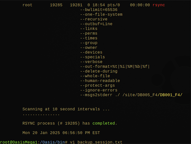

I’m repeating the second test now but this time I captured the tail of heat index listing from the smart data. If I run the smart data dump again in ~four hours when I expect this to fail and the the timestamp on the indexed record has changed that will confirm my understanding of the event timestamps in the smart data.
If anyone has any ideas where to look next to resolve why the drive keeps dropping I’m all ears. I’ve now seen this with two different USB drives using different power supplies and USB cables running on two different Linux distros (Ubuntu and Mint) and two different computers (builder desktop and Dell laptop).

Not sure you’ve thought of this for your situation, but I believe the level of heat generated has to do with the “data load” being handled.
To that end, you might want to look into an option that I use for my own backups when doing rsync:
–bwlimit=RATE           limit socket I/O bandwidth
My own command has the format:
ionice -c 2 -n 7 rsync 		--bwlimit=32768     ${other_options}
If you can establish your maximum datarate, I would recommend you start by trying a –bwlimit value of 80% of maximum to see if your drive fares any better in regard to stabilizing at a Max Temp which is below the self-preservation threshold of your drive.
In my case, I used the bwlimit to limit the amount of memory usage growth during the backup, to avoid flooding RAM with the read block queue pending to be dumped onto the external backup disk. That was the only thing I could get to work for me for my Desktop computer, to allow me to work with sufficient interractivity during full backups.
Example of batch file created by my backup script, so that my monitoring tool started up by the script can give a visual feedback (the dots) that the backup process is still running in background.
Z_backup.DB001_F2.DateSize.batch
echo 'Thu 07 May 2026 10:15:20 AM EDT |rsync| Start DB001_F2
	Process ID => '$$' ...' >&2
	cd /DB001_F2
	rm -f /site/Z_backup.DB001_F2.DateSize.out
	rm -f /site/Z_backup.DB001_F2.DateSize.err
ionice -c 2 -n 7 rsync \
 		--bwlimit=32768 \
 		--one-file-system \
 		--outbuf=Line \
 		--recursive \
 		--delete-during \
 		--preallocate \
 		--links \
 		--perms \
 		--times \
 		--group \
 		--owner \
 		--atimes \
 		--devices \
 		--specials \
 		--verbose \
 		--out-format="%t|%i|%M|%b|%f|" \
 		--whole-file \
 		--human-readable \
 		--protect-args \
 		--ignore-errors \
 		--msgs2stderr ./ /site/DB005_F2/DB001_F2/
echo 'START = Thu 07 May 2026 10:15:20 AM EDT' ;
echo '  END = '`date`
	} 2>/site/Z_backup.DB001_F2.DateSize.err >/site/Z_backup.DB001_F2.DateSize.out
	RC=$?
If interested, I talk about that in another posting, where I also provide a URL to my script library on GitHub.
