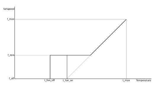

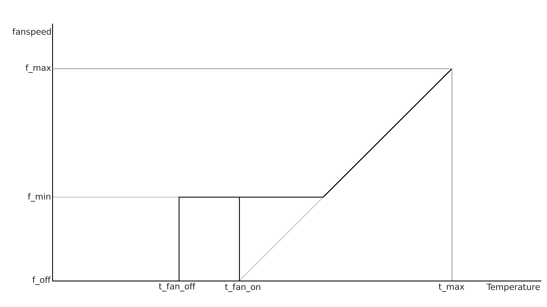

The temperature/fanspeed curve:
I have to reveal that I am artistically challenged so forgive my doodling:
This is the code:

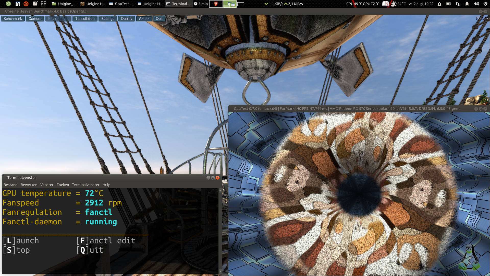

Below you see a picture of both Unigine Heaven and Furmark heavily torturing (a.k.a.
stresstesting) my GPU at the same time, this has been running for 10 minutes before I
took the screenshot and it is keeping the GPU at a nice constant 72°C . Settings of the
fancontroller are the same as in the code above.
(P.S. The terminal with the temp/rpm values that you see in the picture, is not part of the fancontroller. Just a little helper script to view the values realtime)
