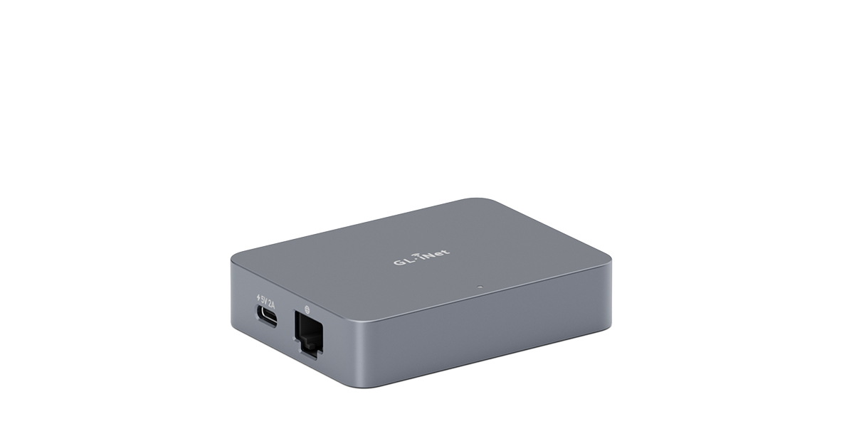

You setup sounds like a good candidate for this:
The GL-RM1 isn’t just a passive USB switch, it’s a network-based KVM (Keyboard-Video-Mouse) over IP device. So it virtualizes the keyboard, mouse, and video input over Ethernet, so instead of physically switching USB between two computers, you can access both machines remotely from a single interface (even with RDP restricted).
Everything runs locally, so there’s no cloud dependency or privacy concern, and latency is almost the same as a physical USB switch.
Of course, it’s not cheap. I could use it in my home lab but can’t see myself spending $100 on something that I won’t use daily.
