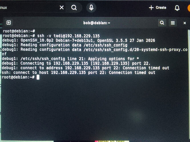

I am launching Ubuntu server on VmWare. My username is tadi@server1. On cmd I can get access the server on the same machine which uses windows OS. However, On the client side
when I try to connect using a different linux machine (laptop), "connection time out " error occurs.

This looks like a network issue, not SSH.
Since you can connect from the Windows host but not from another machine, your VM is most likely using NAT networking in VMware.
In NAT mode, only the host can access the VM. Other devices on the network won’t be able to connect, which results in a connection timed out error.
How to fix this: Change the VM network adapter to Bridged:
VM Settings Network Adapter
Select Bridged (connected directly to physical network)
Then check the VM IP:
ip a
Make sure it’s on the same subnet as your laptop, then connect again:
ssh user@<vm-ip>
In NAT mode, external machines cannot access the VM directly unless port forwarding is configured.
