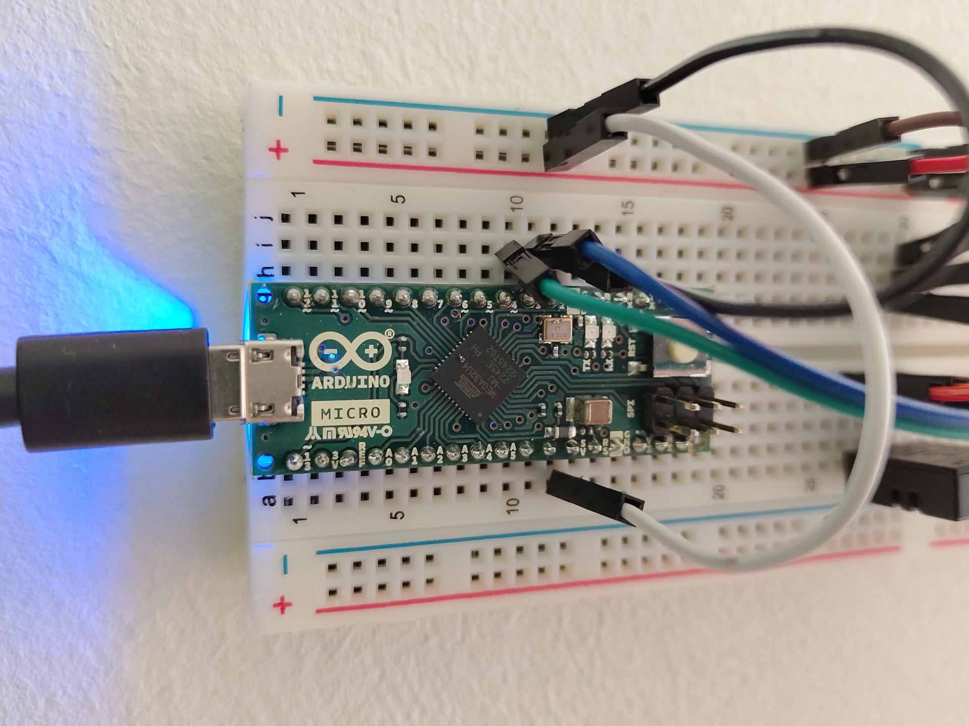

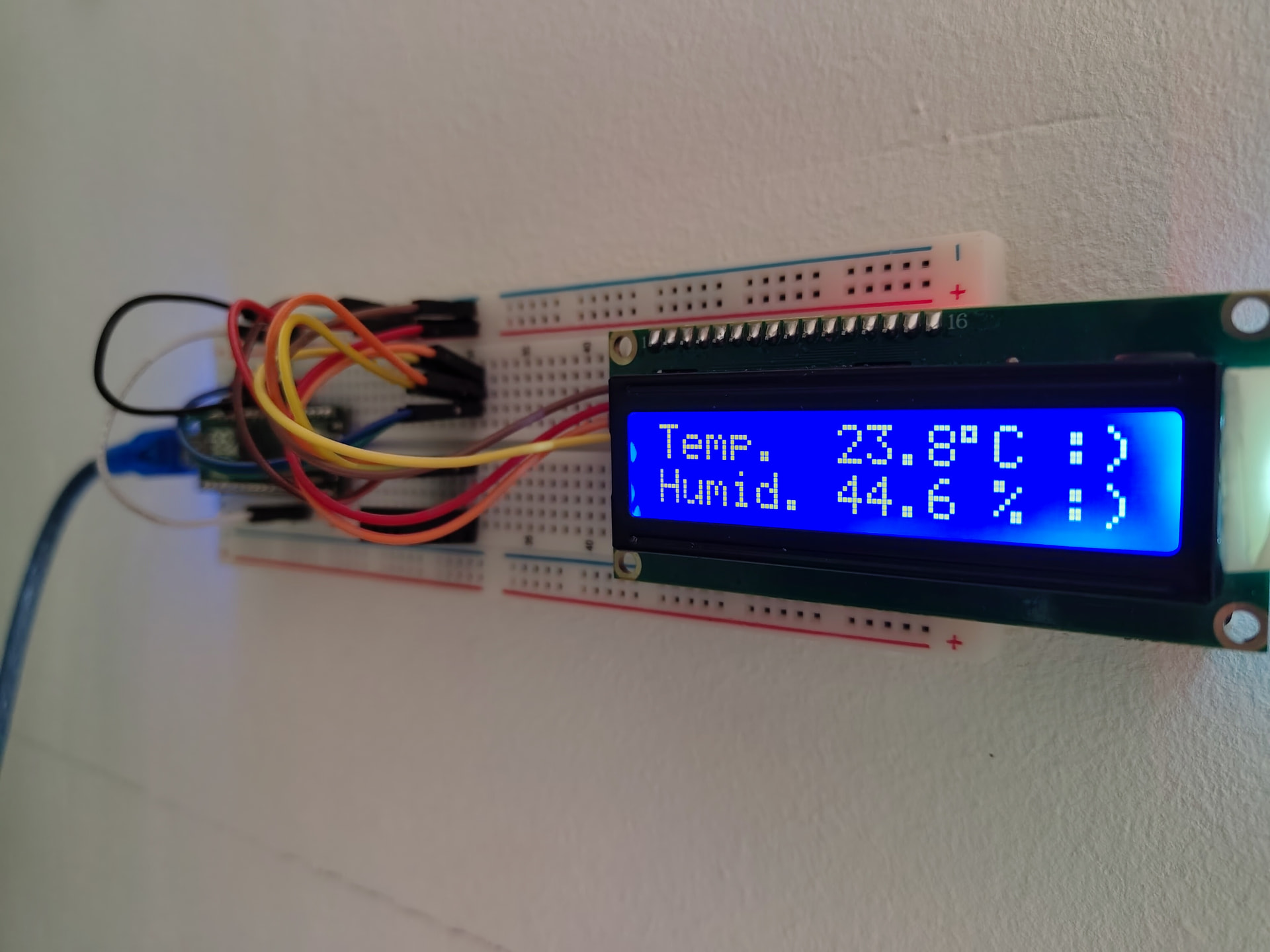

I made a very simple thermo-hygrometer using an Arduino Micro, Adafruit DHT20 sensor, and 16x2 LCD display recently. The latter two both use an I²C interface so obtaining readings and printing output to the LCD was rather trivial. Just a fun little project, and made me itch to endeavour onto more exciting and challenging projects. I’d love to hear things you’ve done with such electronics (and perhaps inspire me!).
I wrote a blog post as well if any one wants more details.

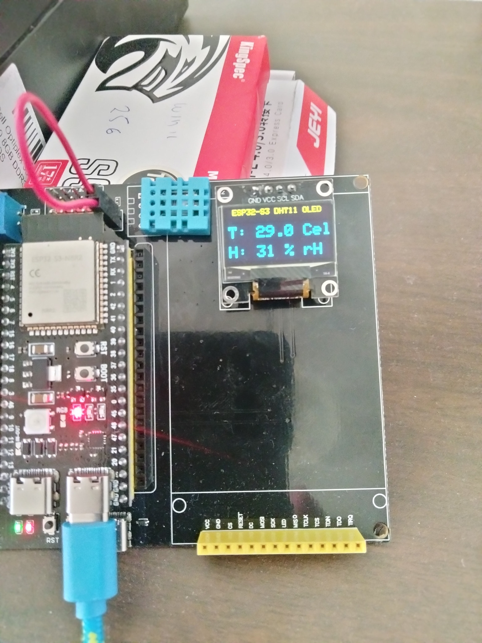

the pi able to do that too ?
yes, on any pi (3,4,5) enable i2c, then connect
  • LCD 1602 display with GND, VCC, SDA, and SCL
  • DHT11 sensor to a GPIO pin, 3.3V, and GND
sample code as text file.
sample.txt (1.6 KB)
Presumably a DHT20 or DHT22 would work as well in that case?
yes, I just have the DHT11.
