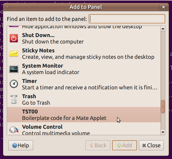

  • TST00Applet is applet’s iid
  • Pay your attention to files’ and names’ naming conventions
  • Location directory mate-ugn has been created to hold ugn’s applets
  • Name and (optional) Icon and Description are shown in Add to panel... dialogue

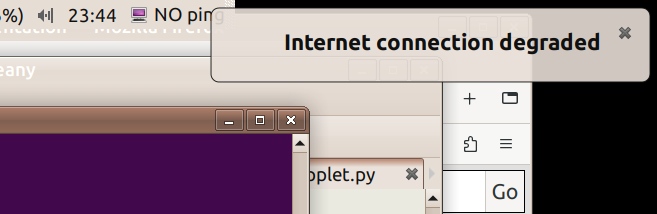

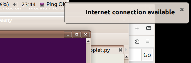

Example: Internet host availability and notification
#!/usr/bin/env python3
# -*- coding: utf-8 -*-
# ping Google DNS host 8.8.4.4 and notify
# ugnvs 4 Ubuntu Mate forum
import gi
gi.require_version('Gtk', '3.0')
gi.require_version('MatePanelApplet', '4.0')
from gi.repository import Gtk
from gi.repository import GLib
from gi.repository import MatePanelApplet
import subprocess
status = None
lastprobe = False
ping_command='ping -4nq -c 1 8.8.4.4'
def update_status():
    global status
    global lastprobe
    res = subprocess.run(ping_command.split(' '), stdout=subprocess.DEVNULL,
                         stderr=subprocess.DEVNULL, capture_output=False)
    result = (res.returncode == 0)
    if result != lastprobe:
        lastprobe = result
        if result:
            txt = 'Ping OK'
            subprocess.run(['notify-send', 'Internet connection available'], stdout=subprocess.DEVNULL,
        else:
            txt = 'NO ping'
            subprocess.run(['notify-send', 'Internet connection degraded'], stdout=subprocess.DEVNULL,
        status.set_label(txt)
    GLib.timeout_add(4000, update_status)
def build_applet(applet):
    global status
    status = Gtk.Label("")
    applet.add(status)
    update_status()
    applet.show_all()
def applet_factory(applet, iid, data):
    result = (iid == "TST00Applet")
    if result:
    return result
MatePanelApplet.Applet.factory_main("TST00AppletFactory", True,
                            MatePanelApplet.Applet.__gtype__,
                            applet_factory, None)
#EOF
