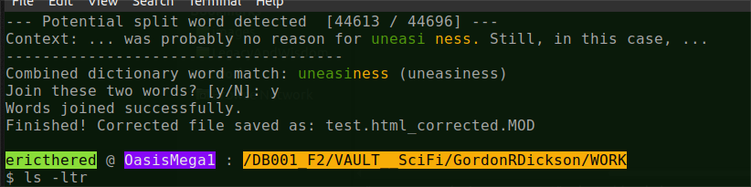

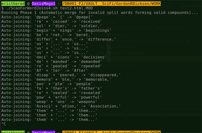

The logic is maybe six lines. Walk adjacent token pairs, and if the joined version is in the dictionary, flag it. Then the filter that kills basically all the false positives: only flag it when the second fragment is not a real word on its own. “excel lence” fires because “lence” is garbage. “may be”, “in to”, “a while” and “all ready” all stay put, and those are exactly the ones a dumb joiner would destroy.
For the approve or skip part, cheapest thing is to dump the candidates and run them through vim with :%s/old/new/gc. That gives you y/n/a/q per match for free. Or build the prompt into the script and add a --yes flag for when you don’t feel like babysitting it.
