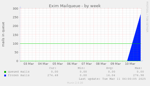

So this morning, the mail queue on that server looked like this:
I checked the logs, read the queued emails and it’s related to the munin cron jobs. Had duplicated tasks because it was not being called from crontab file but rather via /var/spool/cron/munin.
Deleted the duplicate. Restarted crond and cleared the queue:
exim -bp | awk '{print $3}' | xargs exim -Mrm
Hopefully, this helps anyone with a similar issue.
