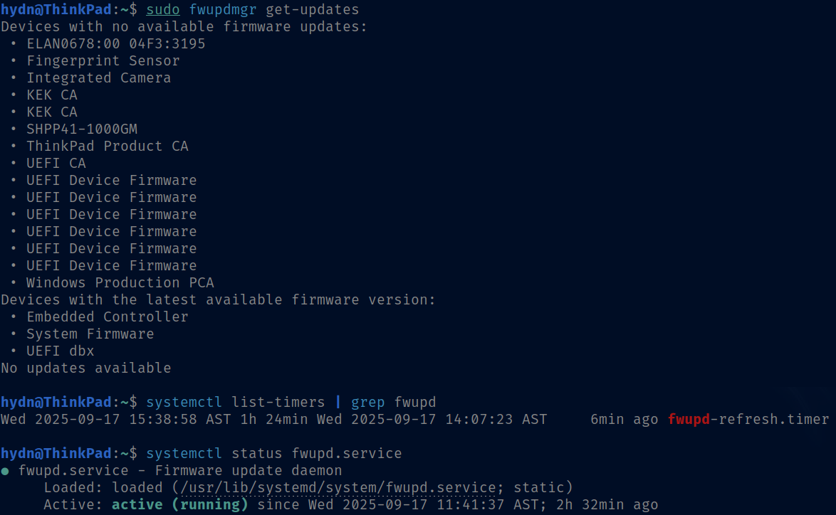

Make sure you have all firmware up to date:
Use a network cable in the meantime to perform tasks that require internet.

Hello again. I just checked my firmware update and found it is over 9 years old. I think I will go through the steps you have linked above and update my firmware before trying anything else. Thank you for taking the time to help me. I will let you know what happens.

Tried to update firmware but it appears nothing happened.
Is there a way to switch from Legacy BIOS to uefi using the terminal?
It still says it is 9 years old. After reboot.
