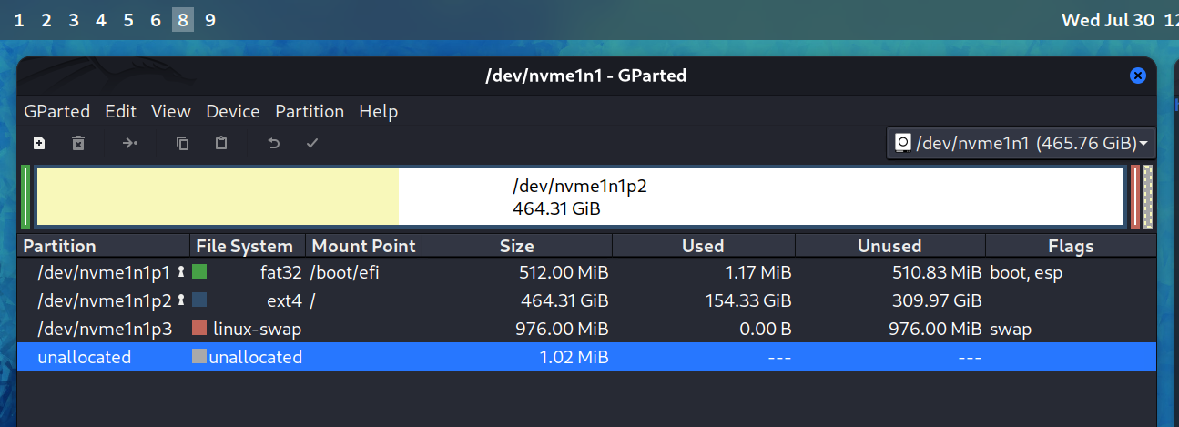

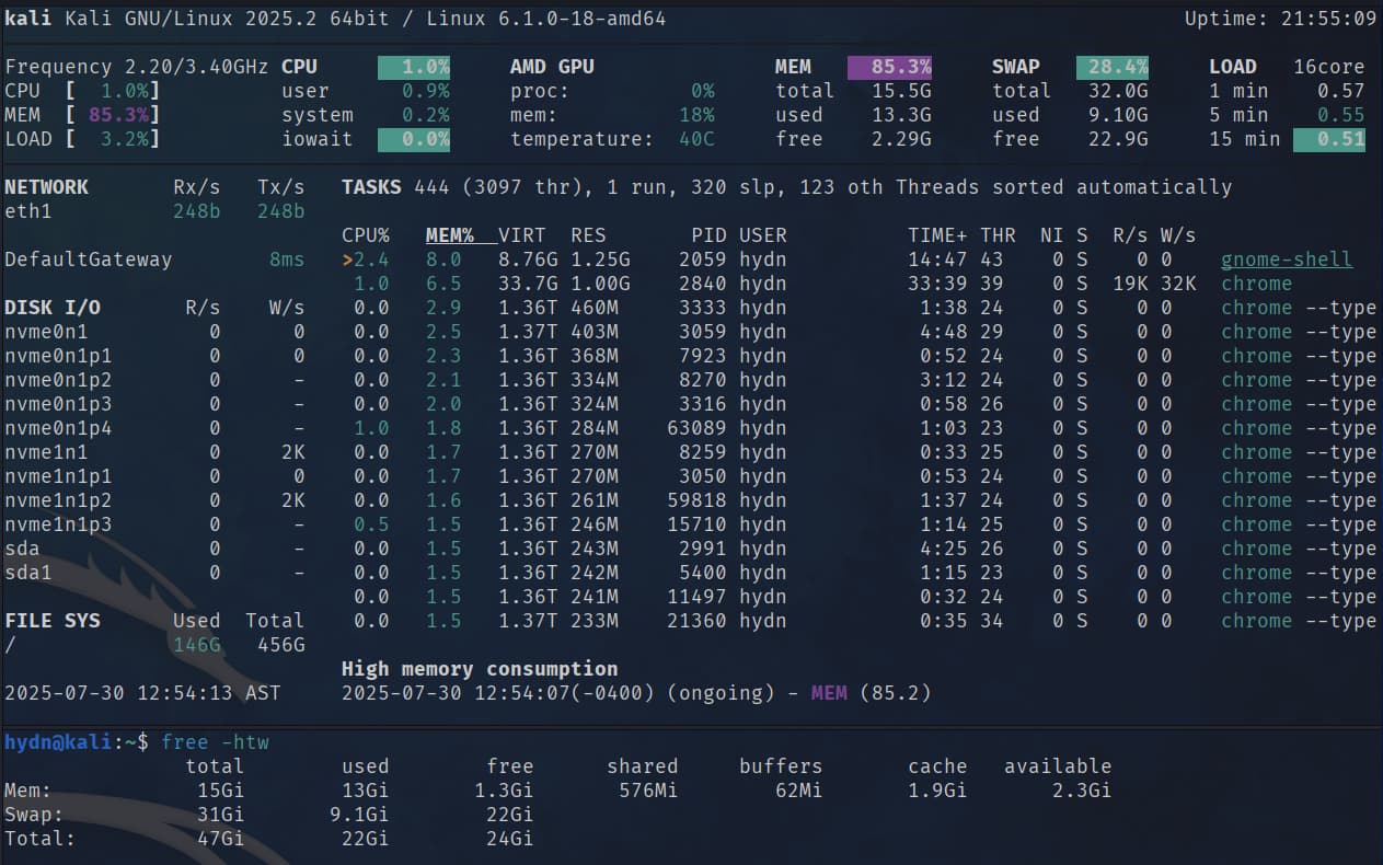

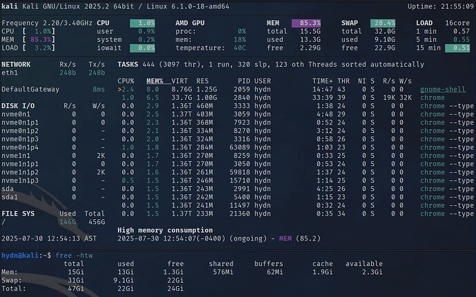

Today I disabled and uninstalled ZRAM, and created 32 GB of file swap (overkill):
At the end of the year I’ll add a 3rd 8 GB mem stick and revert to the 1 GB swap partition, then add ZRAM 25% if I end up using more than 25 GB and face the original OOM/locking issue again.

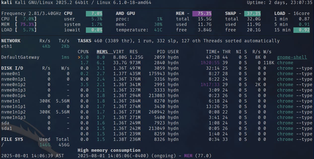

After 2 days of uptime on my workstation, it looks like I could benefit from doubling my RAM:
