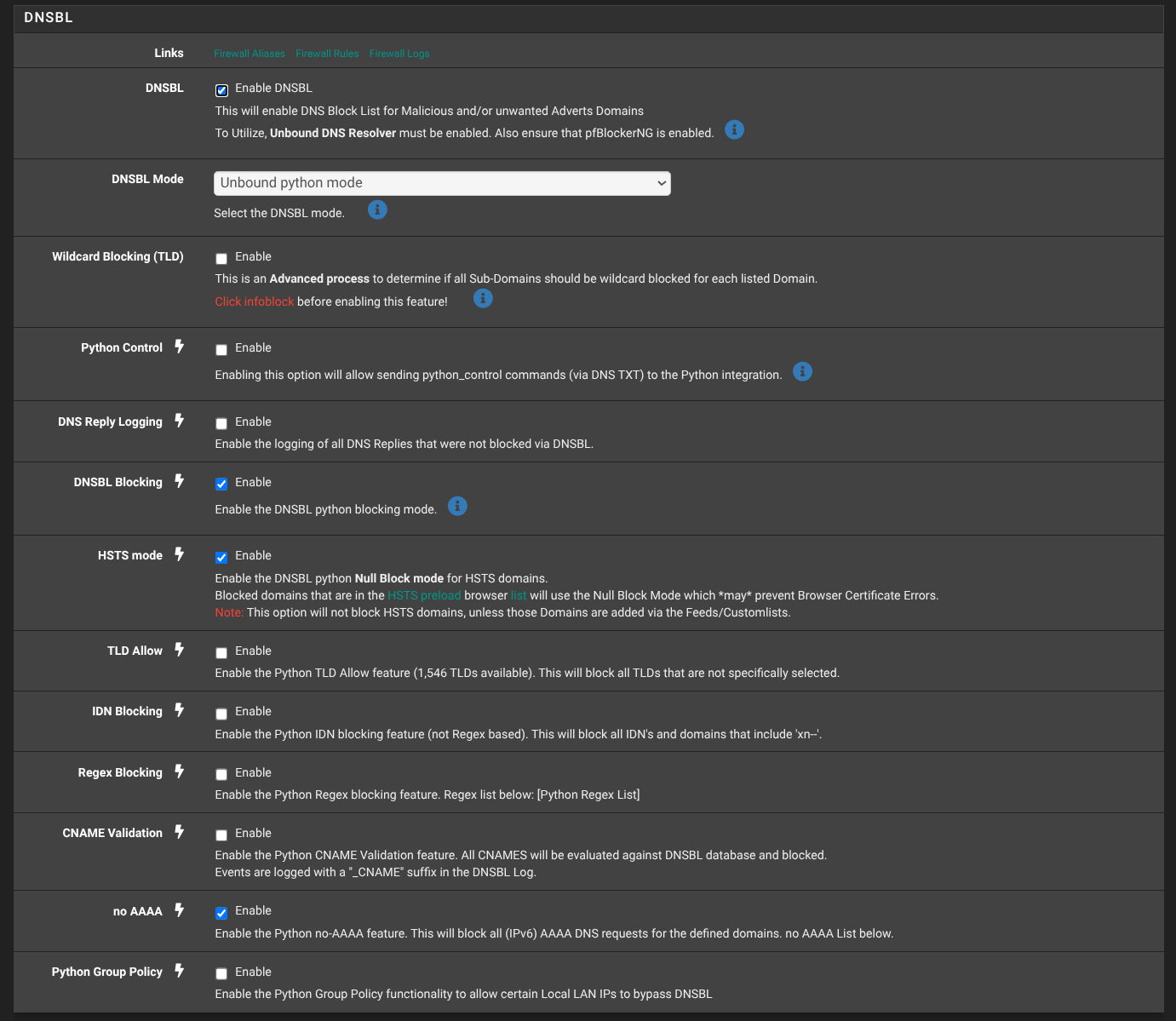

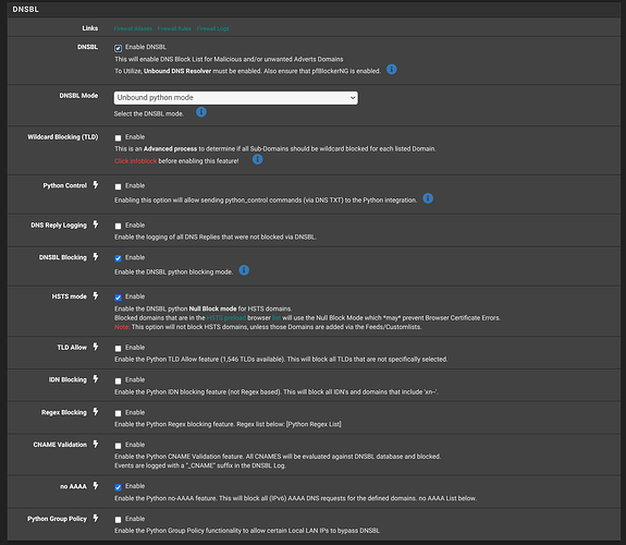

Then also switch to “unbound python mode” which uses SQLite instead of text file:
Disable the DNS relay logging (extra disk IO/CPU)

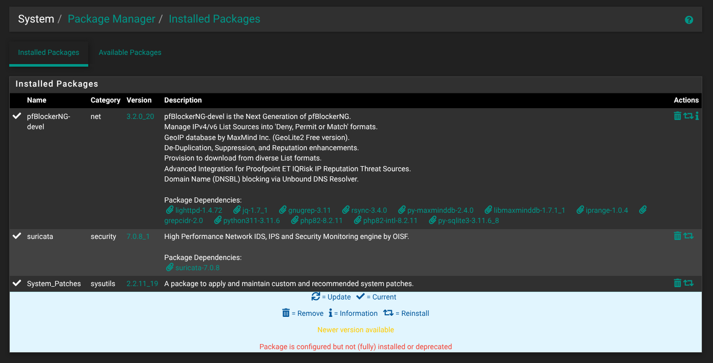

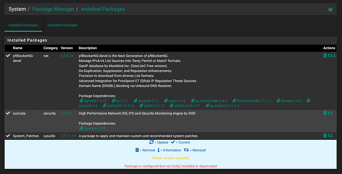

I also found today that sometimes when you restore from a backup, it creates a slow boot that does not go away. In my case, it would spend about 30 seconds on slow starting package system patches.
To fix: Head to package manager:
And instead of using the “reinstall package” option. Manually “remove” (click the trashcan icon) and then install all packages again.
ALL your settings will remain. Then reboot. The blocking during boot when loading packages starts should now be gone!
This does not happen every time I restore, but sometimes, not sure why.
