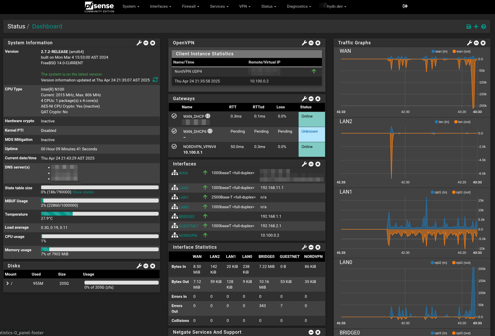

Starting setting up (mostly learning) pfsense today. The device itself is exceptional. The CPU is still near idle @300Mbps using OpenVPN. Eventually, will switch that to NordLynx (even more efficient) but the setup is a bit more times-taking. The 2.5G posts all work well. I’m still waiting on the SFP+ modules and of course the switch. So, like I said, mostly learning. I have restored to factory settings 3 times today already. :joy:
Will be sure to include testing results in part 2.

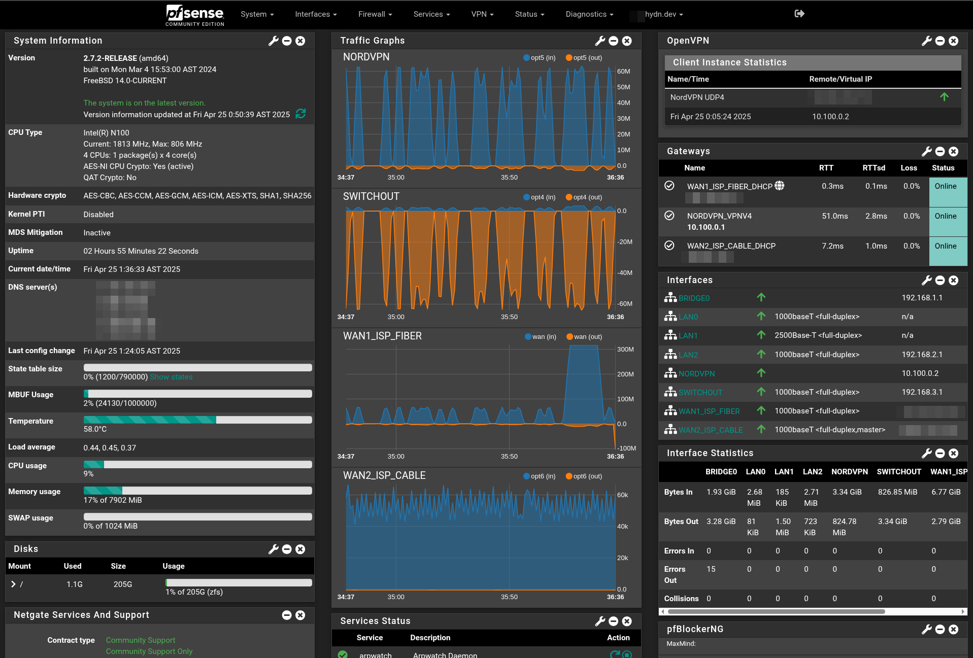

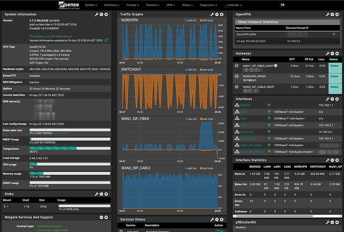

I’ve been setting up pfSense. It’s been an amazing experience thus far. I’m about 90% there. I have a TON to share! Soon, need up to another week or two with it.

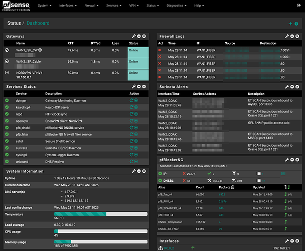

It feels a lot like the days when I first started using Arch, in that, you really get to customize your security stature exactly the way you need and tailor it to fit your network. I have both IDS and soon IPS setup, just the final touches. Have been monitoring and cleaning up alerting/noise.
Have started the process of securing guest Wi-Fi. Inbound but also restriction to outbound in the rare even someone connects with a compromised advice.
Will follow up with more in Part 2 soon, continuing to learn, change and improve config!

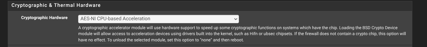

I prefer NordVPN, I’ve been using OpenVPN because NordVPN does not support WireGuard, only their NordLynx. However, I’m getting full ~480 to 500 Mbps symmetric speeds using OpenVPN, so I really don’t see any need to switch. Just be sure to enable
AES-NI CPU-based Acceleration for OpenVPN (best performance):
