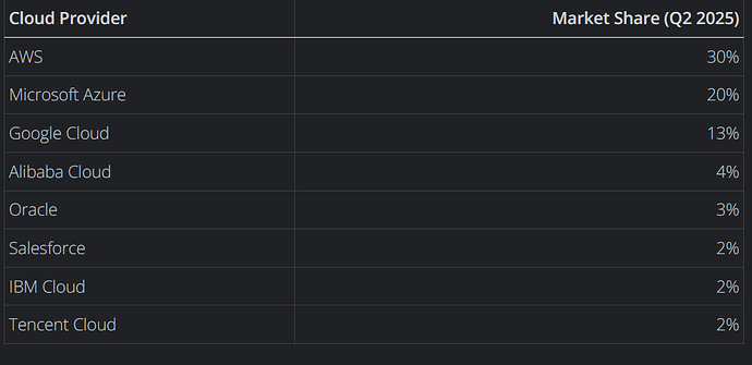

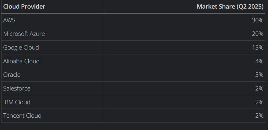

Let’s hope we are never reminded again just how much of the web runs on Amazon AWS again like this. Usually the question is not if, but when! Especially now at this time with so much new/young-technology being integrated into production systems and processes.
