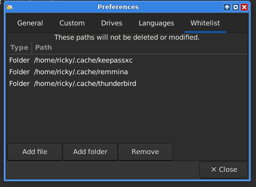

The problem freeing space with software Bleachbit is I was losing some important information, so lately I went deep on this and I discovered in Bleachbit configuration there’s a whitelist section, where you can configure folders you don’t want to being deleted by the software.
The correct procedure is configuring the most important folders in Bleachbit whitelist, I did this for my ~/.cache folder, as you can see in the following screenshoot.

I think deleting temporary files is a best practice, but with this guide you can be safe by don’t letting the software deleting some useful information.
Notice I though in ~/.cache folders there would be only something meaningless, such as some hashed files. But lately I discovered in this folder are still stored some useful information used by various applications.
