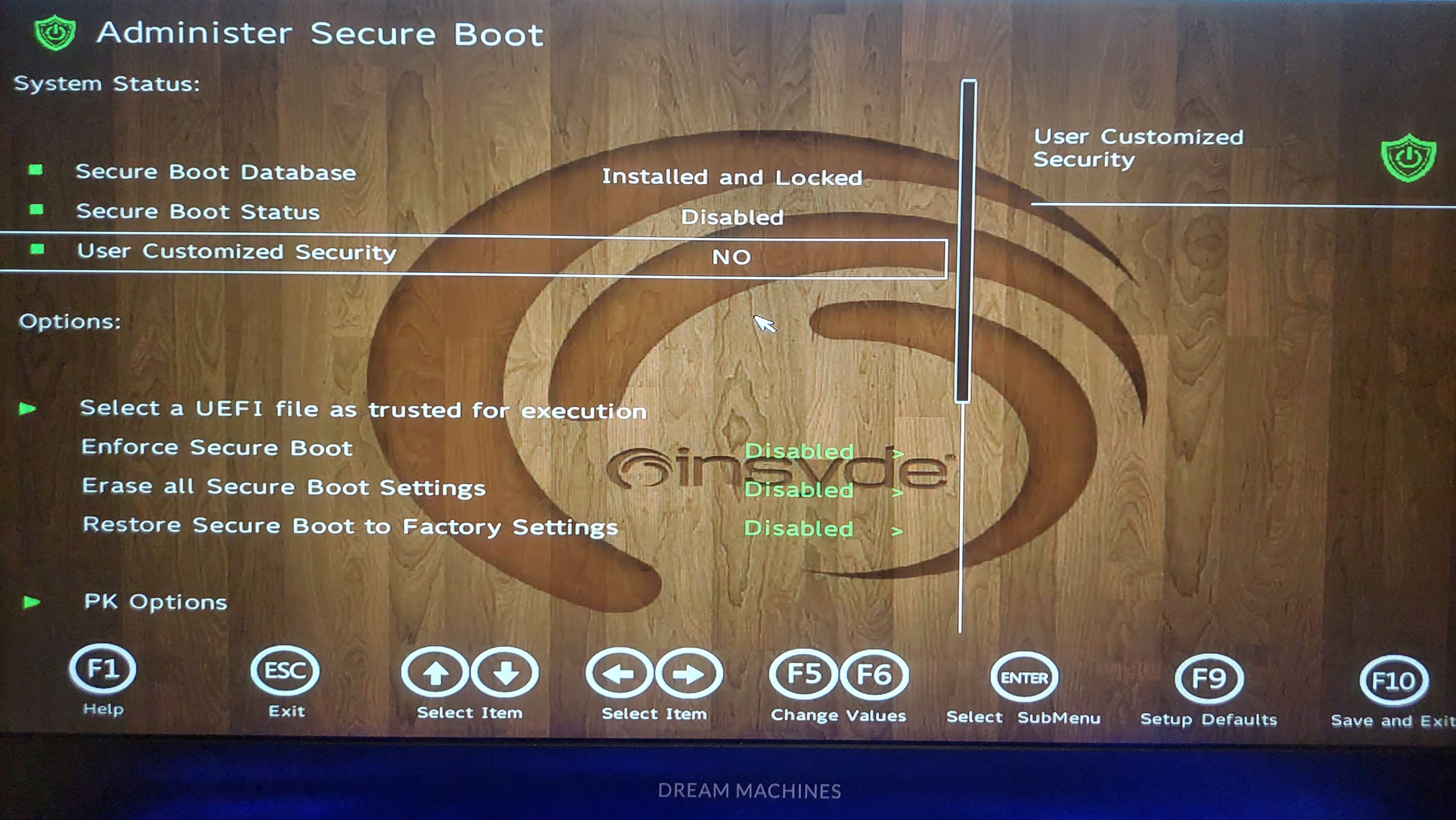

Hello, I’m relatively new to the Linux world. I recently got a computer (from a clevo reseller called Dream Machines). It has 2 disks inside (a Patriot and a Samsung). I installed Windows 11 Pro on the patriot, which is also the first one. However, I use Linux, and only in specific cases do I enter Windows. On the Samsung, I installed PopOS (the disk used to have Windows inside). The entire installation was successful, but the bootloader doesn’t work. Instead of disabling secure boot, I set “enforce secure boot=false” to uefi. I should also say that I want to experiment with Linux, so I was thinking of installing CachyOS on a partition on the Samsung. I tried to solve the issue by installing grub, but it didn’t work, I had read that they don’t fully support it. In PopOS, I have a problem with the RTX5060 drivers, the system sees it but can’t use it, so it only uses the integrated Intel. Finally I have a problem with the fans which I can’t control. Pressing Fn+1 they work but I can’t hear them working on their own (but the laptop doesn’t get hot).

Pop!_OS uses systemd-boot by default, which can act weird if Secure Boot isn’t fully off. Instead of “enforce secure boot=false,” disable Secure Boot completely in your BIOS.
Once you finish that, run:
sudo bootctl install
If it still doesn’t boot, efibootmgr will show whether the entry exists. If you later install CachyOS, letting it use GRUB can make managing all OS entries simpler.

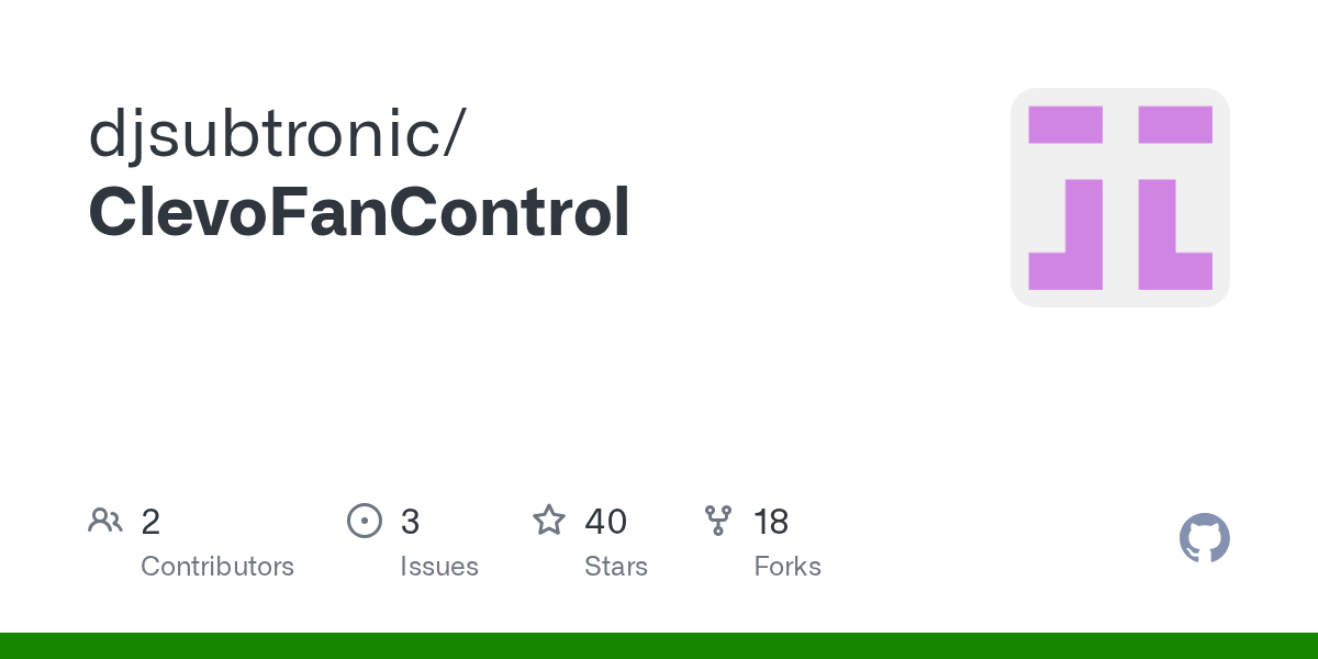

Look for a matching Clevo profile or something close to your model. You can also check if the kernel is loading WMI properly:
dmesg | grep -i wmi
Disable Secure Boot fully, stick to one EFI partition on the first drive, and install all OSes in UEFI mode for smoother dual/triple boot.
