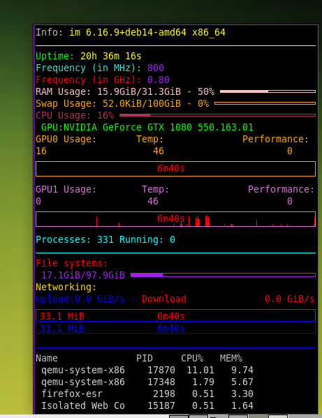

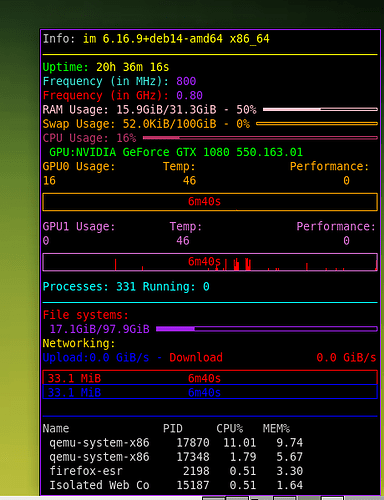

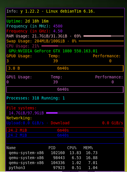

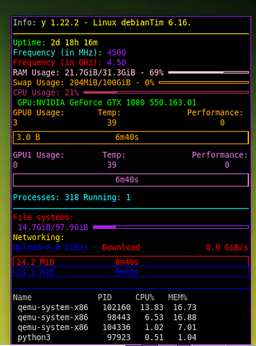

Okay I’m confused, I have conky setup how I want it for the most part. But on my GPU section I have the exact same code for GPU 0 & GPU 1 and they appear differently.
and
As you can see GPU 1 doesn’t display like GPU 0. There isn’t any change in the GPU usage section in GPU 1 it shows 0 all the time and never changes. It also doesn’t display the graphs the same, GPU 0 has a Bit size (?) or whatever that number preceding the “B” in the graph for GPU 0.
Here’s the code I have currently:
${color green} GPU:${nvidia modelname} ${nvidia driverversion}
${color orange}GPU0 Usage:       Temp:              Performance:
${nvidia gpuutil 0}                   ${nvidia gputemp}                      ${nvidia perflevelcur}
${nvidiagraph gpuutil 0 }
${color orchid}GPU1 Usage:        Temp:              Performance:
${nvidia gpuutil 1}                   ${nvidia gputemp}                       ${nvidia perflevelcur}
${nvidiagraph gpuutil 1 }

Well it kinda works better? Conky looks like this now:
the number&“B” no longer shows in GPU0’s graph (orange)
The graph is moving but shows 0s for GPU 1’s usage & performance.

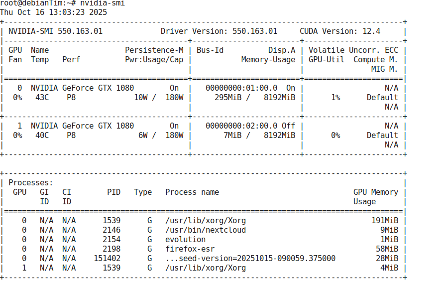

NVIDIA-SMI shows this:
So it’s sort of working better?

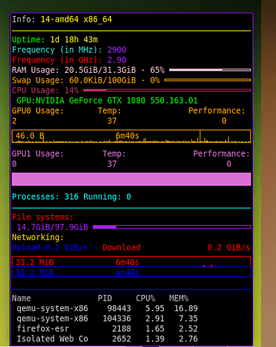

I changed the code to this:
${nvidiagraph gpuutil 0 40,200 8e59faef-cee9-258c-a5e4-0b525715b9d2 -l -t}
${nvidiagraph gpuutil 1 40,200 bfce9776-2218-66a3-2ae1-85b5e52077eb -l -t}
I guess I’ll just have to live with it for now. The graph shows GPU 1 is working and you would think that 0 changes with the graph, but apparently not.
I also ran nvidia-smi -q (with the query option) I’d post it but that’s a very long output.

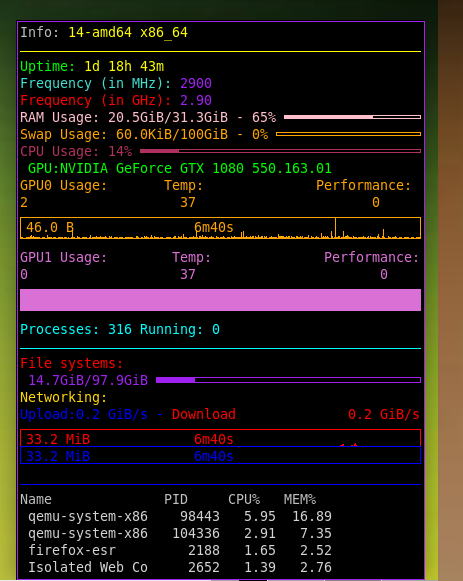

For anyone that cares, I finally figured out Conky is reading the bridge not the actual GPU’s. I wound up taking the code out for GPU1 altogether and the code for the utilization, temp, and performance for GPU0 as well, so now it just has the graph that monitors GPU0.
It now looks like
this:
and the code looks like this:

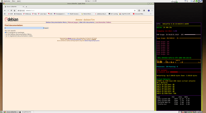

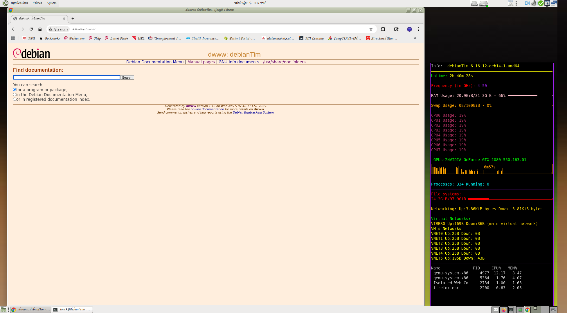

Hi Ricky,
I’ve changed my set up, What do you think of this:
Here’s the code:
