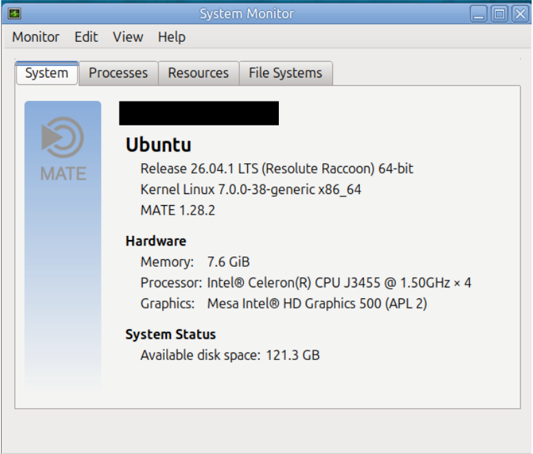

P.S. (Attention @suivue ) At first I suspected it might be the fault of mate-terminal, but I checked. It is still at version 1.26.1, even though this upgrade to 26.04.1 supposedly upgraded the desktop to 1.28.1. Either the mate-desktop.org release notes are in error and an upgraded mate-terminal was not released, or the upgrade process from 24.04.5 to 26.04.1 did not perform a complete upgrade of the mate desktop. I’m beginning to suspect the latter. Here’s why:

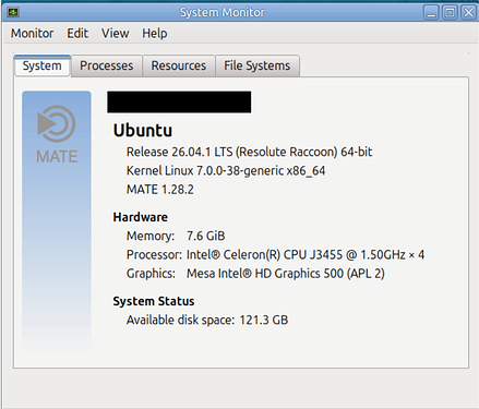

My System Monitor shows MATE 1.28.2:

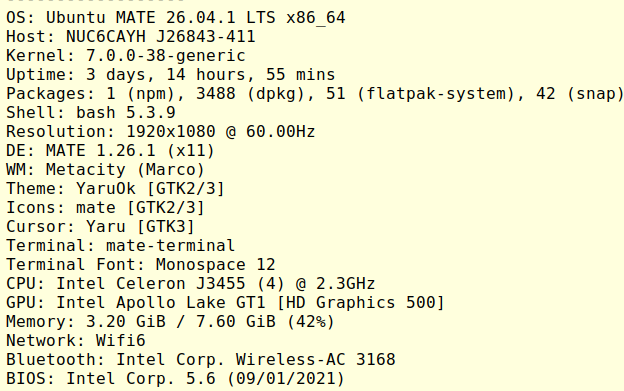

But hyfetch shows MATE 1.26.1:
And apt reports both 1.26.1 and 1.28.2:

@DeanHighland Hi,
I see how it can be confusing. I had the same doubt few months back. Things started to get clearer after I started assisting with (Debian) packaging. Short answer is: We (Debian/Ubuntu) have not transitioned into MATE 1.28 completely!.
MATE desktop project contains several sub-projects/components. At the (Debian) packaging level, not all of these components have been upgraded to their latest upstream version. What you are seeing is ‘mate-desktop’ package which indeed is at version 1.28.2 but ‘mate-terminal’ is not upgraded and still at version 1.26.1.
Debian has shortage of packagers and those who are packaging are over-stretched. Since deciding to work on reviving UM, I am working with Mike Gabriel (Debian developer and MATE packaging team member) to upgrade MATE packages in Debian. We managed to upgrade several packages but unfortunately that did not match Ubuntu’s release schedule and we missed their (stonking) freeze dates. Some packages are upgraded and available, some upgraded but did not make it to stonking release, some still need to be upgraded.
My focus after stonking release will be to,
  • help upgrade all remaining MATE packages to their latest released versions.
  • for stonking (and resolute, in that priority), try and patch (not upgrade) as many packages as possible to fix bugs.
Hope this clarifies.
